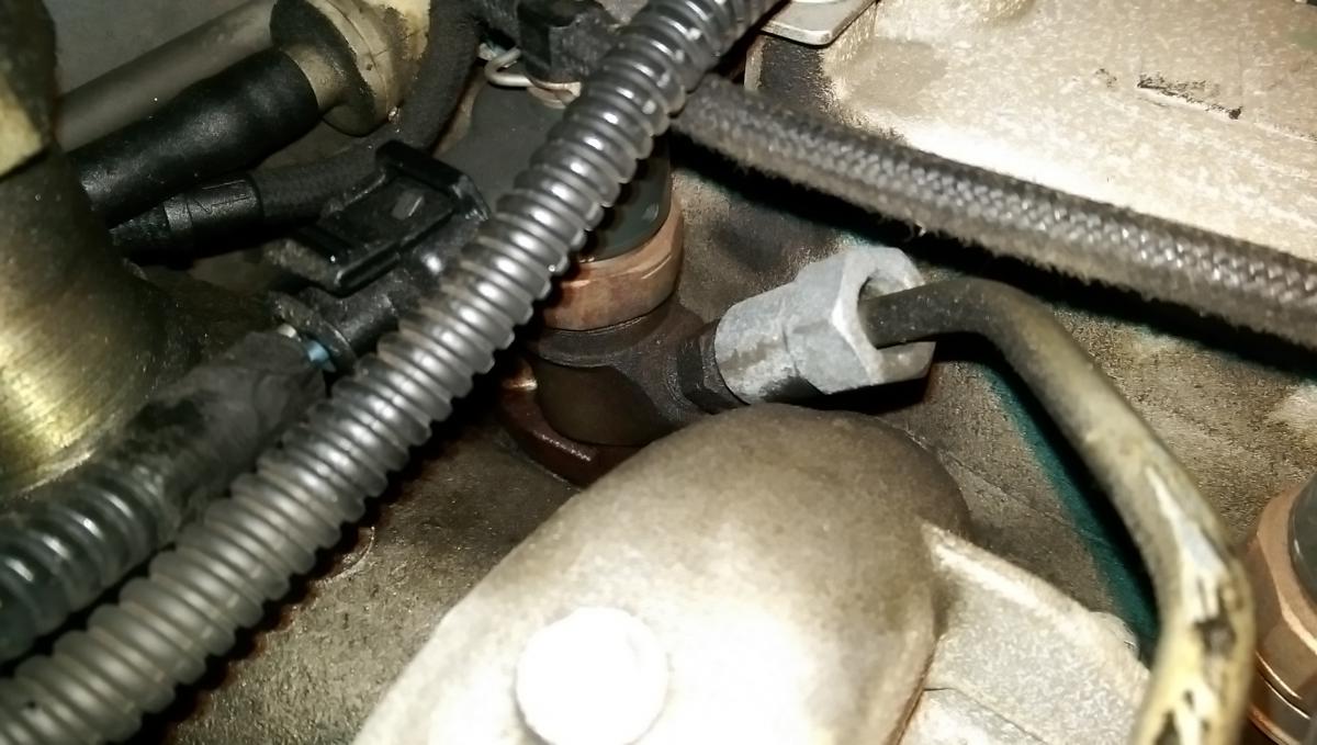

I found a leak from one of the injectors. Went to dealer, but he asks a lot of money to replace the o-ring seal or even more money to replace the injector. Local garages refuses to do the job, they think that injector have been stuck and they do not have right tools.
I found on eBay this one http://www.ebay.co.uk/itm/181887489722?_trksid=p2055119.m1438.l2648&ssPageName=STRK%3AMEBIDX%3AIT
I was wondering if anyone has any experience with removing injectors, will this tool will be right for the job?
