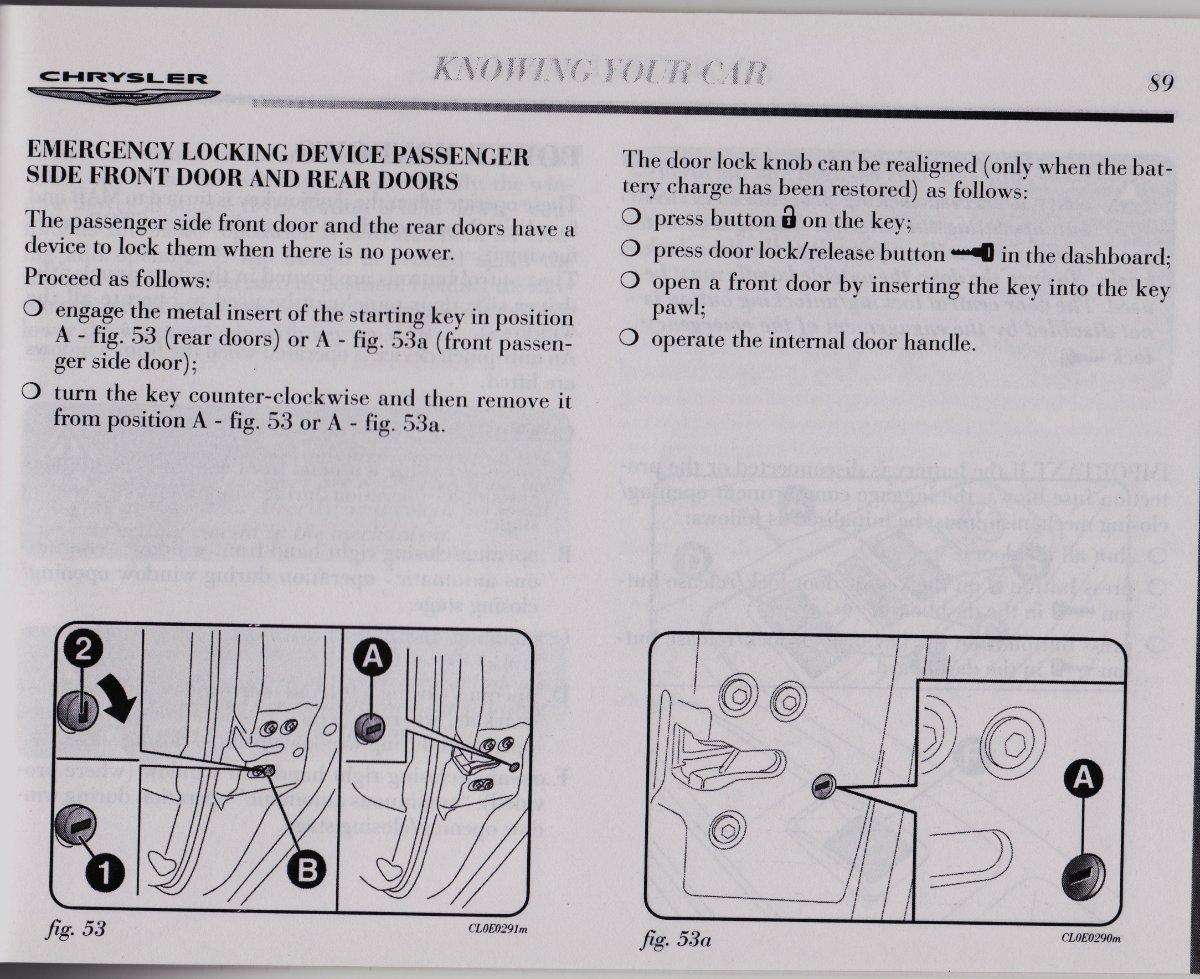

Just a note to confirm that the Delta can be locked without the battery charged or on.
I copied page 89 from my owners manual that shows how to lock the car when there is no battery power. I actually did try this on my front passenger door and it works. The key cannot be inserted all the way into the slot shown - all that is required is the tip of the standard key inserting and the slotted insert can be rotated around 45 degrees and the door will be locked once closed. This was prompted by a post on anther group and I hope it helps somebody out. I also hope I remember it.. Best, Frank B
FrankB
