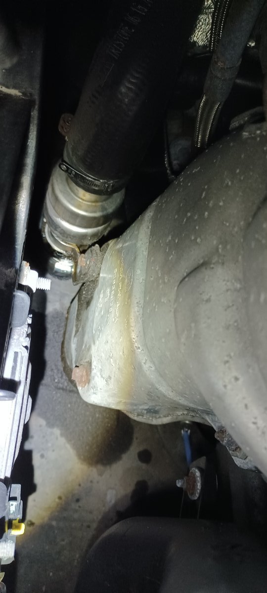

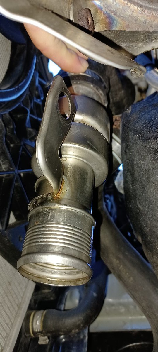

The other oil leak was hard to find but it was coming from or near the turbo hose by the exhaust manifold heat shield. After close inspection I have found that the aluminium coupler/joiner between two hoses (turbo charger-intercooler) has a crack. Probably due to being close to exhaust.
There is no part number and I can't seem to find this part anywhere except some used ones but they might be suffer from similar problem soon.
I have attached the photos of the part.
