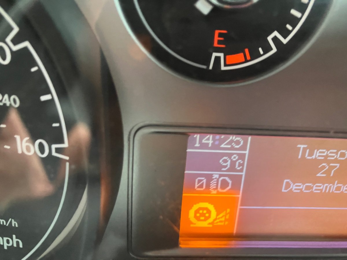

savage Posted December 30, 2022 Report Share Posted December 30, 2022 Hi could any one tell me what this symbol represents as it has appeared on my dash board and I cannot find any details about it I have a 2013 delta 1.6 diesel thanks in advance Quote Link to comment Share on other sites More sharing options...
0 Andrewgrale Posted January 1, 2023 Report Share Posted January 1, 2023 It's the anti skid warning light Quote Link to comment Share on other sites More sharing options...
0 ForzaLancia Posted January 8, 2023 Report Share Posted January 8, 2023 your traction control is switched off or faulty. More likely the former, the button is on the centre console and around the same location as the heated rear window button, so it is easy to hit the wrong one. If it were a fault it is likely the ABS light would be on too as they use the same sensors to determine wheel rotation speeds. HTH Quote Link to comment Share on other sites More sharing options...

0 seagoon Posted February 22, 2023 Report Share Posted February 22, 2023 On 12/30/2022 at 3:20 PM, savage said: Hi could any one tell me what this symbol represents as it has appeared on my dash board and I cannot find any details about it I have a 2013 delta 1.6 diesel thanks in advance Hi I believe its the Turbo it could just be that a pipe from the turbo or from the inlet that is possibly loose check out the clamps Quote Link to comment Share on other sites More sharing options...
0 Deltamike Posted March 3, 2023 Report Share Posted March 3, 2023 On 2/22/2023 at 6:56 PM, seagoon said: Hi I believe its the Turbo it could just be that a pipe from the turbo or from the inlet that is possibly loose check out the clamps As said above, it's the symbol for ASR being off, nothing to do with turbos. The boost gauge will show if you have low pressure, along with (usually) some extra noise and a lack of performance Quote Link to comment Share on other sites More sharing options...
