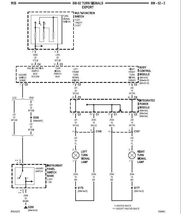

Malawiboy1 Posted November 29, 2022 Report Share Posted November 29, 2022 Hazard And Indicator Problem -help it a 2004 model 2.4 UK model I cant not find the indicator relay if someone can guide me to the right direction so far I have changed the front fuse box but still and the stalk no luck below i have put the vin number if any one has the repair diagram pleases any suggestions same as this guy on utube can someone help please https://www.youtube.com/watch?v=yajOLh752pk VIN 1C8GHN3B95Y526300 thanks in advance for your time Quote Link to comment Share on other sites More sharing options...

0 RichardM Posted December 15, 2022 Report Share Posted December 15, 2022 Maybe this circuit diagram will help ? - Treat all info from the workshop manual as suspect (from experience) Malawiboy1 1 Quote Link to comment Share on other sites More sharing options...

0 RichardM Posted January 14, 2023 Report Share Posted January 14, 2023 Did you solve this ? I note you said you changed the stalk, this, as far as I'm aware does not form part of the hazard circuit. The common bit are the BCM onwards. Quote Link to comment Share on other sites More sharing options...
