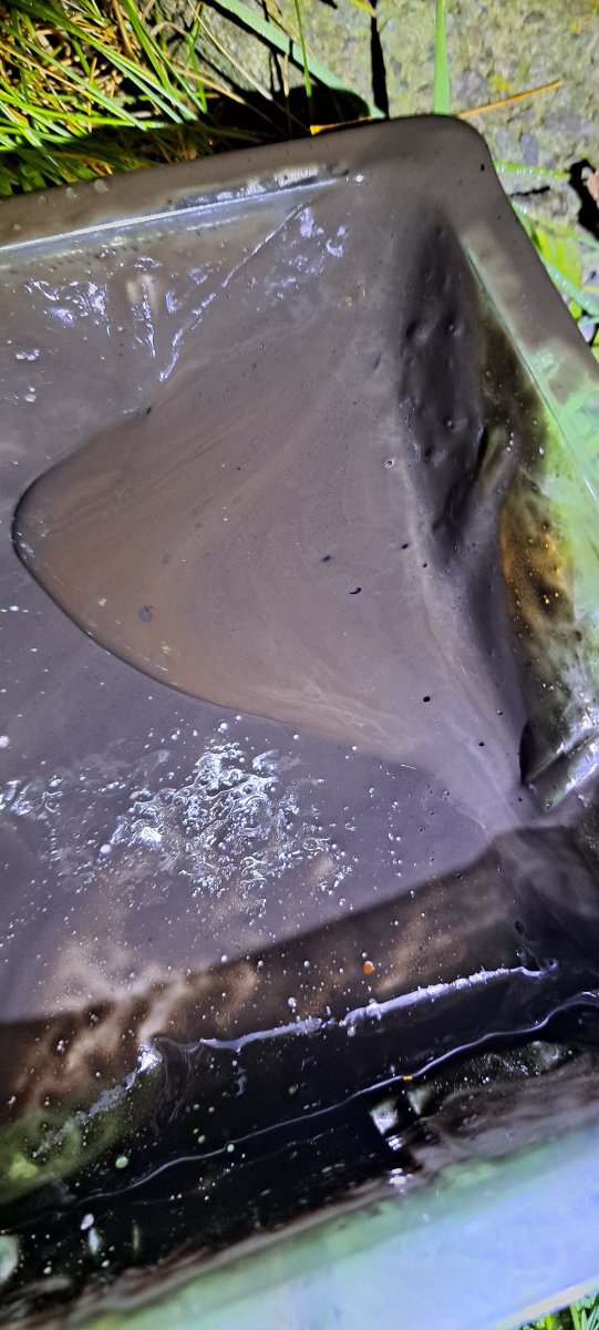

Matthew Posted November 19, 2022 Report Share Posted November 19, 2022 I have a chrysler grand voyager 2.8 crd does anyone have any idea what causes this in my water take its black sludge Quote Link to comment Share on other sites More sharing options...
0 RichardM Posted November 20, 2022 Report Share Posted November 20, 2022 Suggest you run a pressure test on your coolant system, the common, but not only cause of black sludge is oil getting into the coolant system (usually) from the head gasket. There are other causes possible including the addition of an incompatible anti freeze. A coolant pressure test should identify if you have a leak and if so where the leak is. If no leak a flush and refill with recommended anti freeze should cure the problem. Quote Link to comment Share on other sites More sharing options...
0 Sergejs Posted November 23, 2022 Report Share Posted November 23, 2022 This is Oil cooler. The one where you screw in oil filter. This is weak point of this engine. Just change cooler, flush the system and it will be o.k. Quote Link to comment Share on other sites More sharing options...
