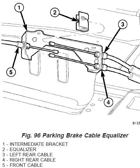

Voyager4 Posted August 19, 2022 Report Share Posted August 19, 2022 I need a front handbrake/parking brake cable. There are four on the vehicle and I can get the centre and rear cables but not the front which runs from the handbrake. Help please - MOT failure! Quote Link to comment Share on other sites More sharing options...

0 RichardM Posted August 28, 2022 Report Share Posted August 28, 2022 Sorry gordy you've read it slightly wrong.. there are three cables for the hand /parking brake. A front (forward) cable runs from the handbrake lever to an intermediate bracket, this connects to two rear cables that connect to the rear brake mechanism.. or so the manual says!!!! If you're still trying to locate a cable & ebay can not help try 1stchoice.co.uk - I've used them before (not for the GV) and they're pretty good Quote Link to comment Share on other sites More sharing options...
