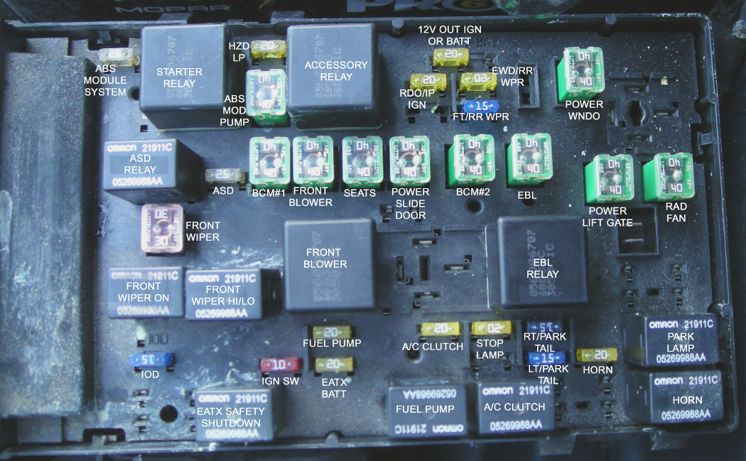

My wife had a flat tire yesterday and used our 12v pump to blow it up to get her to a garage, but the drivers side power point and also our after market HIFI have now stopped working.
Could anyone tell us where the fuses are for these and which fuses we should try to replace?

It might not be as easy as that. First port of call, check the RDO/IP IGN fuse as shown in the attached as cripsinchurch as hopefully that's all it is.
Next one to check would be the movable fuse marked 12V OUT IGN OR BATT, as some installers may choose this if they've bypassed the wiring harness to get around the amplifier or other components (and spliced into the power loom going down to the 12v lighter socket).
