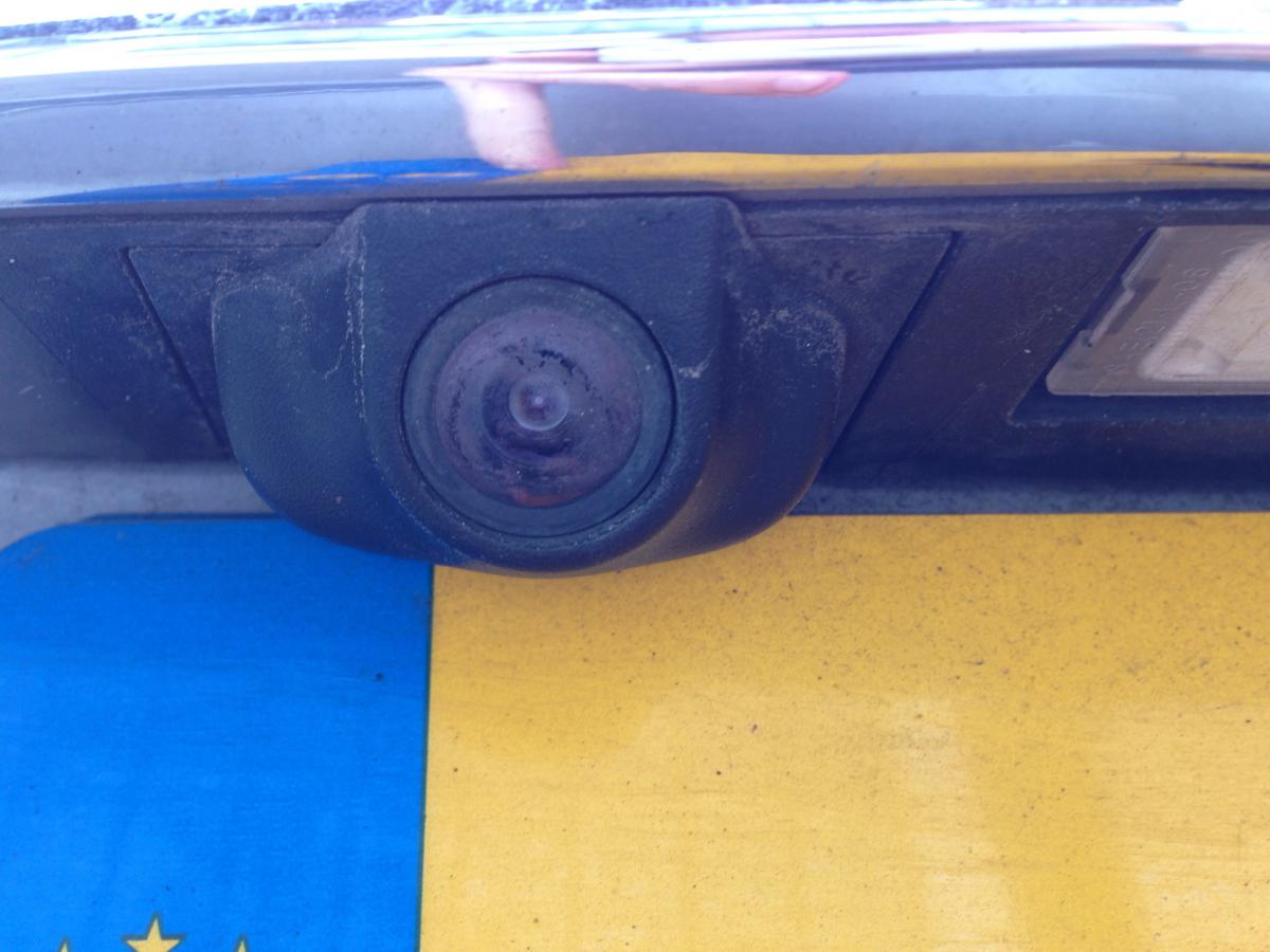

I have a 2009 model which seems to have an issue with the reversing camera - I shift into R and it switches on OK, however it's pretty much useless. It's so blury I can't see anything, is there a way to focus it, or am I looking at a replacement?

The camera focus is set and can't be adjusted, however due to the location of the camera it's not uncommon for the lense to be obscured by dirt.
Have a look at your rear number plate at the top left you will see the camera unit, if you wipe the lense with a cloth and ensure it is free from any dirt, it should make the image a lot clearer
