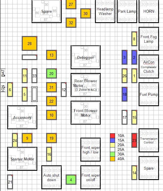

0 RichardM Posted April 12, 2022 Report Share Posted April 12, 2022 Attached layout of fuses (as per mine) ..but the fuse labelled Transmission does bugger all.... Apparently there is another fuse under the power distribution module adjacent to the flitch.. was searching for it some time ago but other things came up (don't you love the Yanks..?) Quote Link to comment Share on other sites More sharing options...
0 MatthewKelly1247 Posted April 12, 2022 Author Report Share Posted April 12, 2022 Yer and thank you Will look at my fuse box tomorrow Quote Link to comment Share on other sites More sharing options...
0 RichardM Posted April 15, 2022 Report Share Posted April 15, 2022 I don't know if this is of use to anyone, it's the fuse's value & wiring relating to the above image... Fuses.pdf Quote Link to comment Share on other sites More sharing options...
