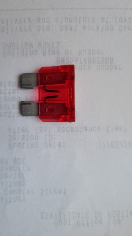

The problem is now sorted out finally, I'm one happy Delta driver who can now stop humming to himself as he goes about his day. I did have a bit of a fight with the boa constrictor of wiring getting the stereo out & then back in but it's done now and the culprit was as rightly said by Andrewgrale (cheers mate) a little 10amp fuseIMG-20220317-WA0000.thumb.jpeg.a7136adbd1b19c51f0800bdfcfc41da3.jpeg
