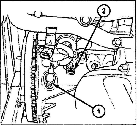

Now to the point of this ramble, does anyone have details and hopefully images of the procedures normally used to replace the C/shaft sensor on aMK4 2007 (2006 type) 2.8CRD ??????

Thank's for the response, it wasn't so much where the sensor is on the engine but what Chrysler have bolted around it on the Stow & Go as opposed to the (i NOW ASSUME) standard voyager shown in the uTube video. Well it seems like they stuck everything they could find  to obstruct access. I will try and get some pictures taken when it goes back in for the rest of the work to be completed......
You can replace this sensor without disconnecting anything , i did mine on normal car ramps you can reach over abs unit disconnect the plug remove single screw and pull the old unit out
I got a new replacement from ebay , its bit of a fiddly job just got to get yourself in the correct position
