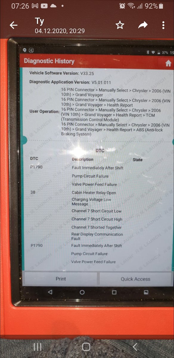

problem still not solved. One claims the pump, the other one that the alternator charging is too low. I replaced it with a new alternator. Same readings 13.85V under load and 2.5 RPM 13.65V. I also have a P1790 error here and Chanel 7 Short Circuit Low, Chanel 7 short circuit high and shorted together. Please help. I will be extremely thankful

P1790 was when I change the oil in the gearbox (automatic) Now does not pop up.  Could you recommend a workshop that hve code reader suitable for my car and that could test the ABS correctly. I have also on Channel 7 short circuit Low, Highe and Shorted together.  Maybe know which cable it is?  Maybe this is the cause of the ABS problems?
I had this with my last voyager , I purchased a creader CRP 123 code reader .it tells you what sensor is faulty ,IE left front sensor no reading . speed each wheel is doing while you are driving ,( if it doesn't read a certain wheel , it is obvious.) allows you to reset codes , a bit expensive, but any good garage should have similar equipment. I'm not a garage but mess around with a few cars and this has paid for itself many times over. I bought it when a garage billed me £60 to tell me an abs pump was faulty . And £150 for the reader. would save me in the long run. And it has
