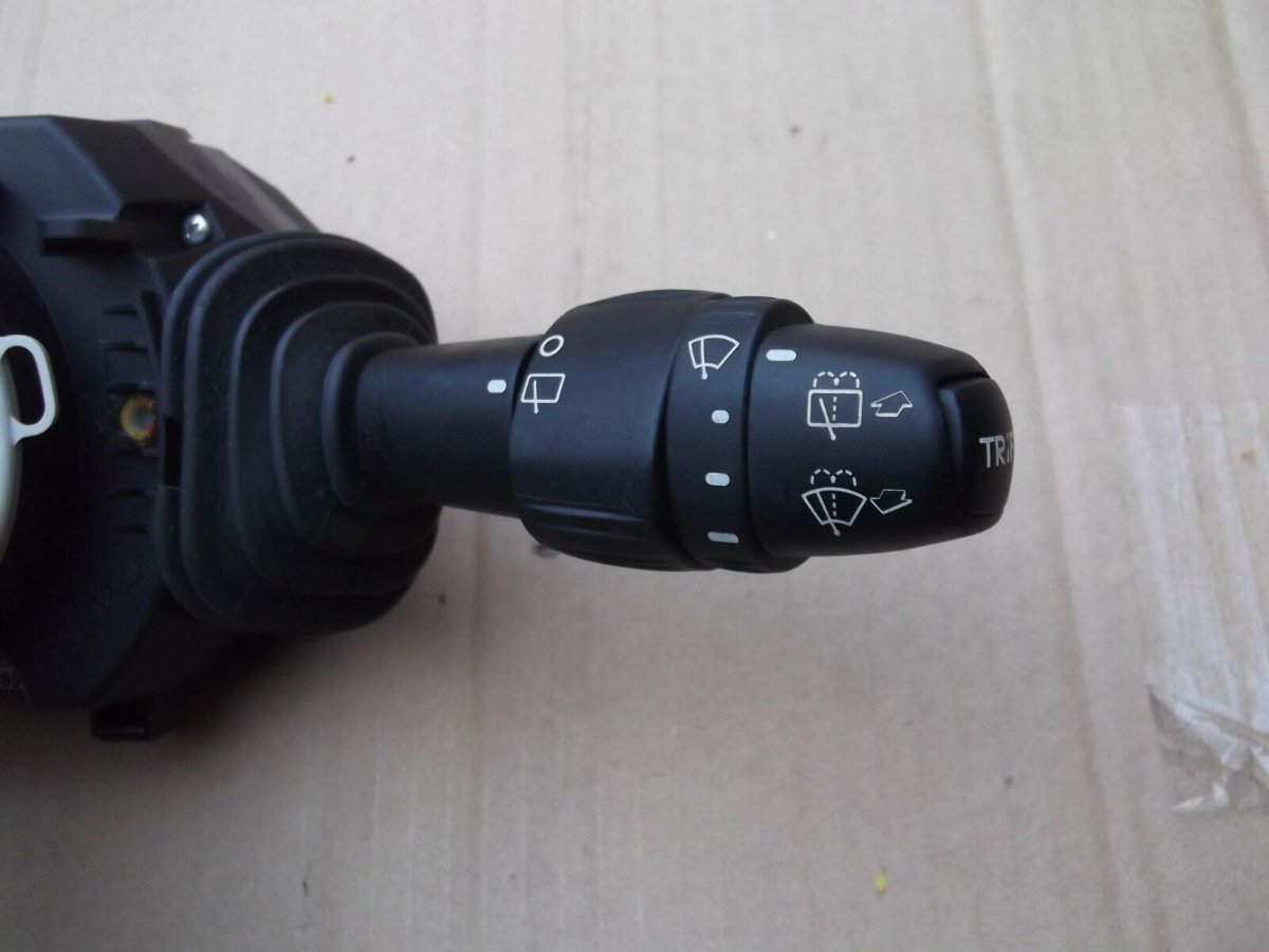

Secondly, is there no rear washer?

There is a rear washer, you push the RH stalk forwards.  From the column going out along the control stalk you've the large-ish rear wiper control, then the intermittent front speed control (both twist to operate) & then the rear washer push forwards & front washer pull backwards (does sound a little contrary)!
