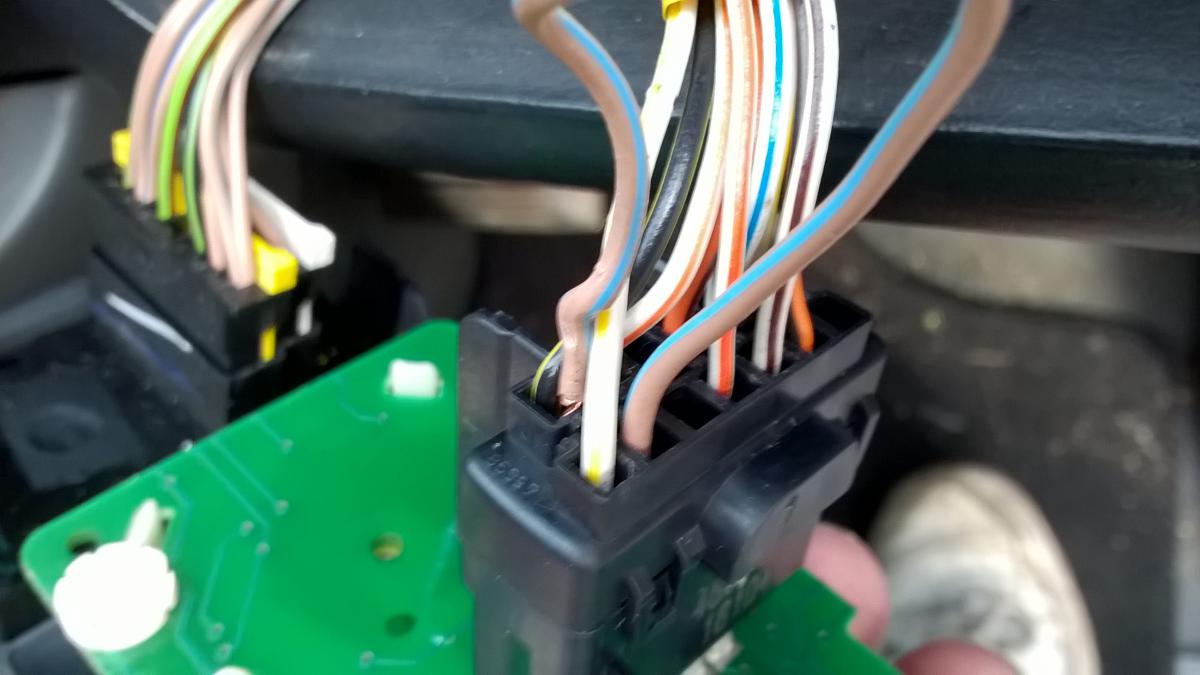

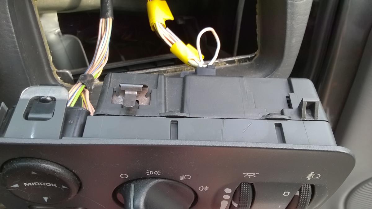

I will try to take a picture of the wiring loop you need to put in to make it light up. The terminals are different on the 2 models of switch, but you only need one wire link between 2 terminals, took a bit of experimenting but I got there!
Edited by bignev
Okey dokey then - @robbie2red
With the wiring connector fastening clip to the left,looking down on the wires from the car, link the nearest left (black with yellow stripe) and second nearest right wires.
Yes, on the newer car connector there is no outgoing wire in the right terminal.
It's easier if you release the plastic panel below it first, then attempt to reach up and under to release the 4 metal clips that hold the switch assembly in.
