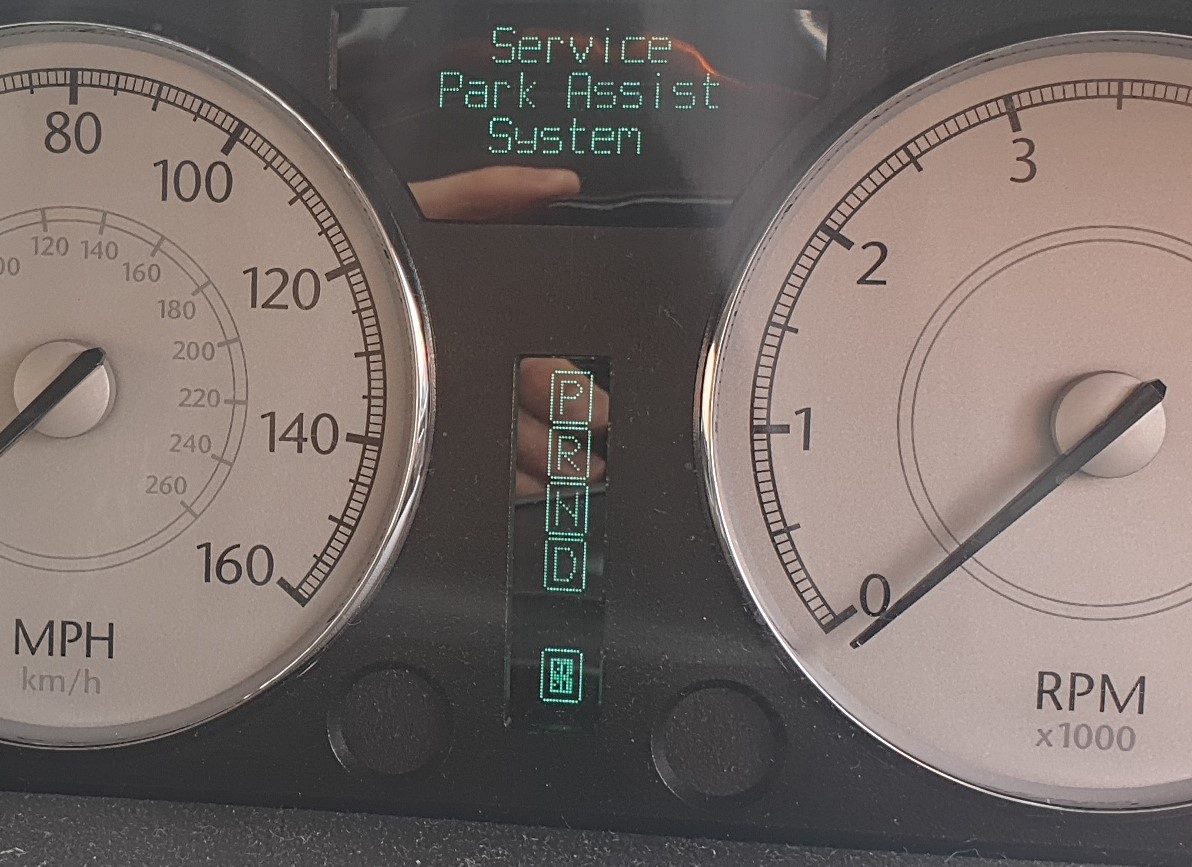

Car dashboard says “service park assist”

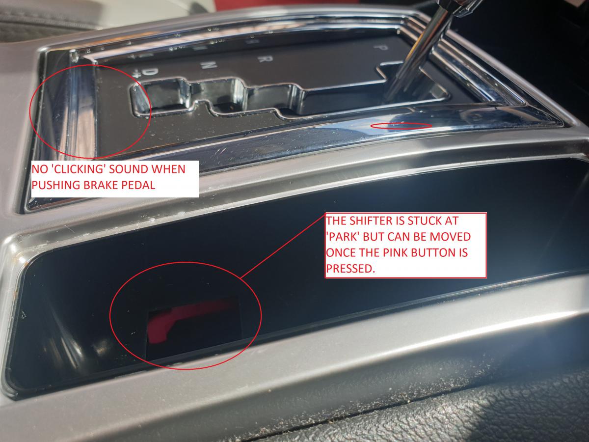

Transmission shifter stuck in ‘park’ however I can move to ‘D’ when pushing the secret pink button on the side. There is a speed limit with only 1st gear working.

One day I went to the local gas station. After top-up, and 5min of calm driving suddenly most of the dashboard lights turned on like a christmas tree + service park assist + the charging voltage was around 17Volts. So I pulled to the side immediately and called for recovery to the local garage.

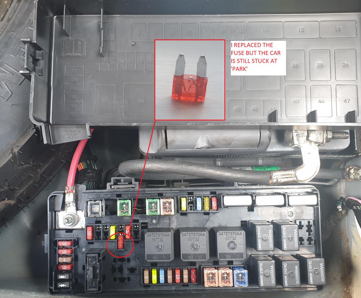

I took the car home, checked visually all the fuses in the front and back and found only 1 burnt, but the car shifter is still blocked.

it seems it is not the 'pink thingy' issue, but rather shifter solenoid - am I correct? When I’m pushing the brake pedal I cannot hear any ‘clicking’ noise. Where can I find that solenoid? What is part No.?

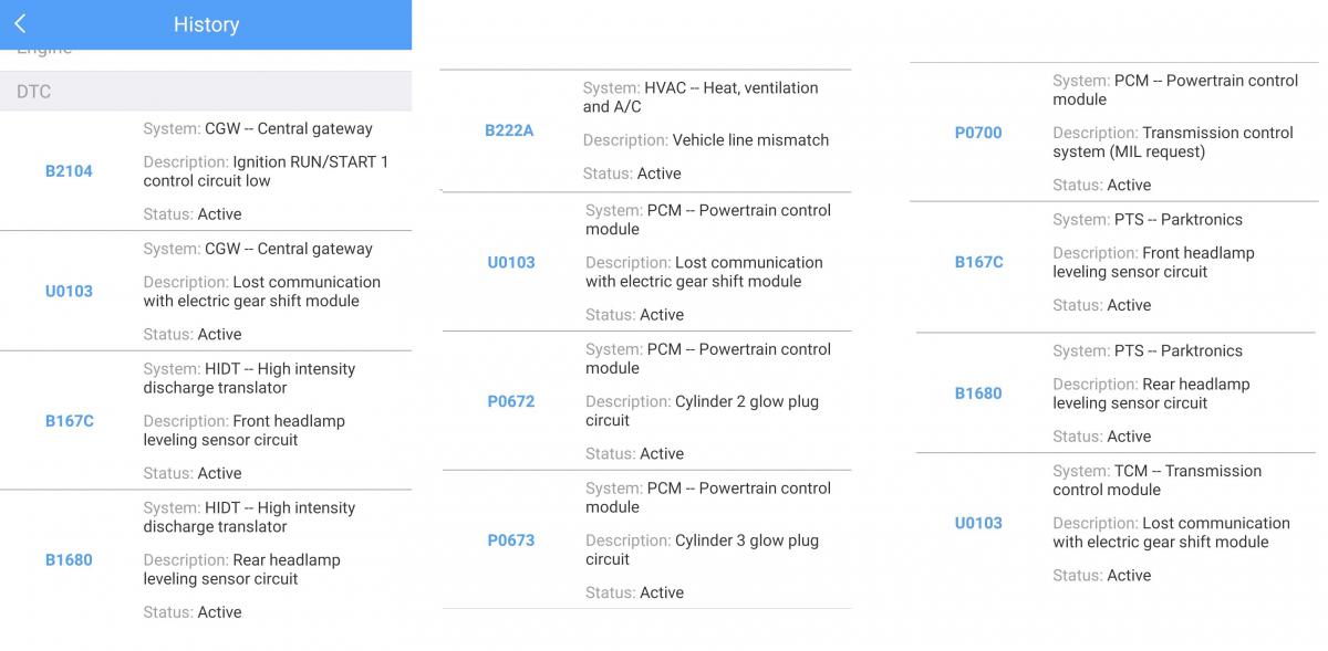

What else I could sort out myself? When looking at the active error codes… Is my car totally messed up now?
