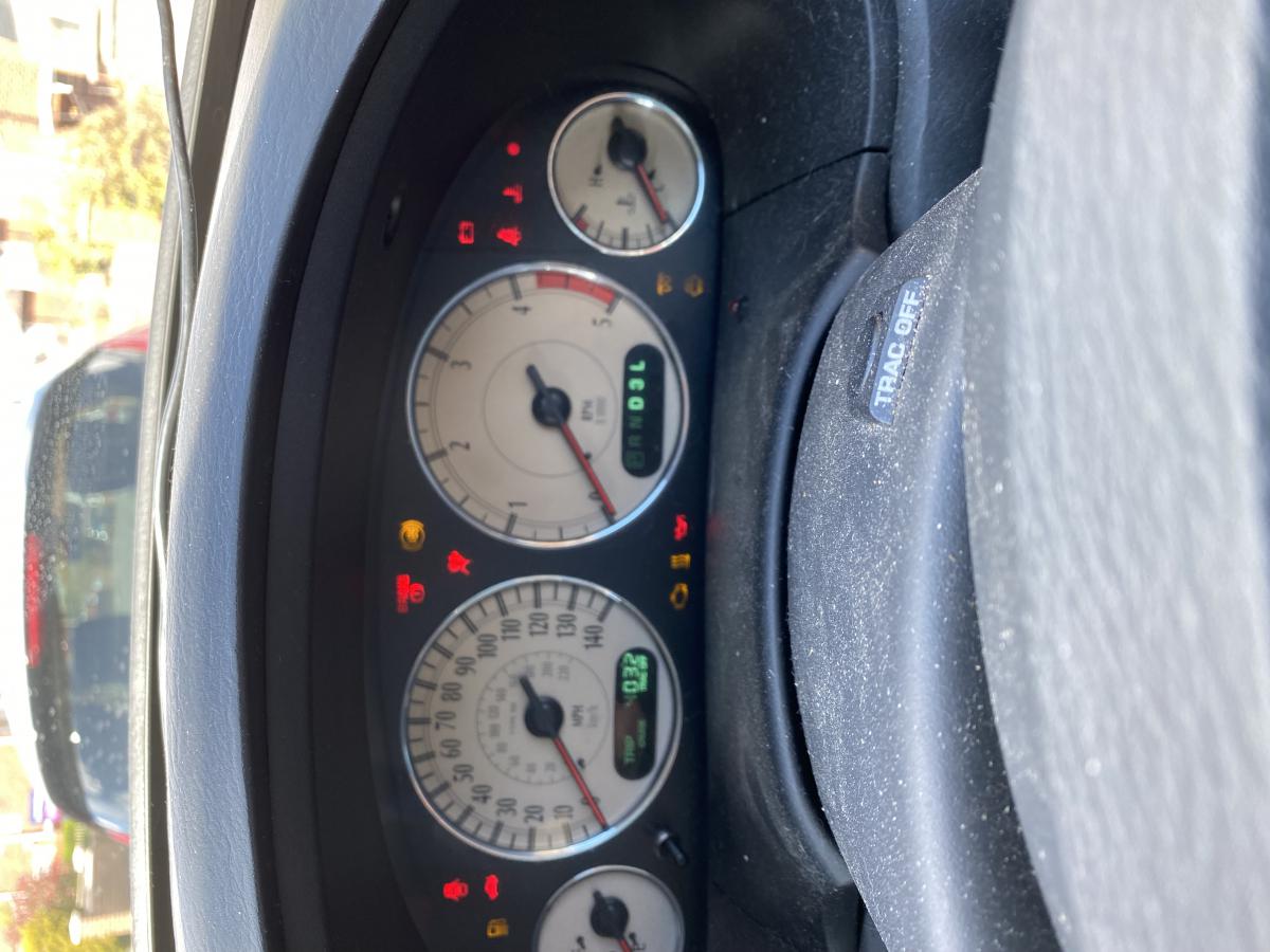

Hi L Plates, in my GV 2007 2.8 xs executive has a orange light at the bottom which I have been told is a cabin heater, this comes on when interior is cold, mine works intermittently until the fuel tank is less thank 1/4 of a tank and then it doesn’t work, the engine preheates are to the right of the Rev counter in between the fuel gauge, above the screen wash empty light. will try and add a picture, but not terribly good at posting pictures.
hope this helps
PJ
