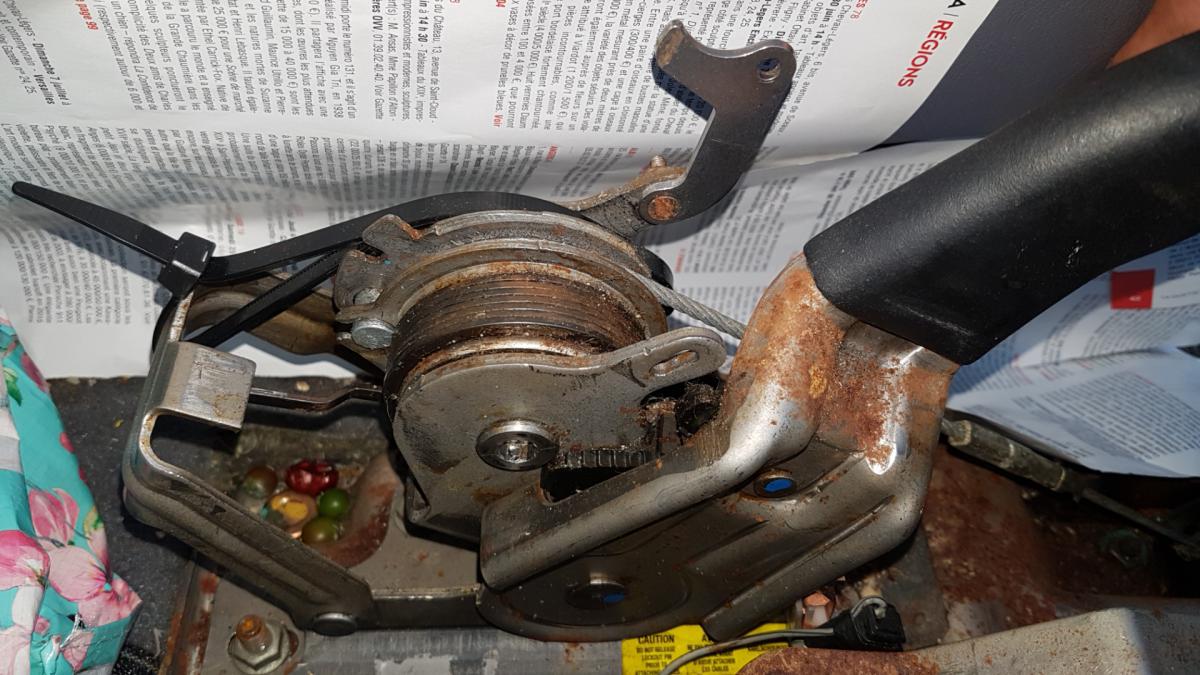

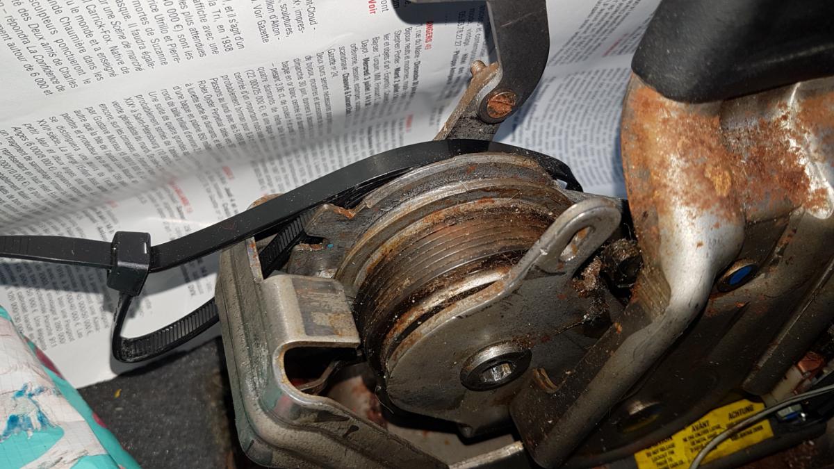

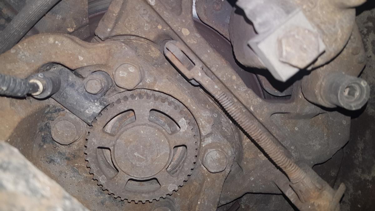

cuddlycarprayer Posted March 29, 2021 Report Share Posted March 29, 2021 Hello everybody! My handbrake springs are a bit weird and the cable doesn't auto tighten, its too loose for the M.O.T. Theres also a metal pressed latch which doesnt do anything. What can I do with all this to tighten it? Quote Link to comment Share on other sites More sharing options...
0 timb02 Posted March 30, 2021 Report Share Posted March 30, 2021 You are right the handbrake does not auto tighten. there is a blanking grommet in the bottom of the rear disk back plate that allows access to the adjuster. with the wheel off the ground tighten each one until the wheel binds with the handbrake two clicks up. the hand brake on GV's is poor at the best of times so don't expect too much. The cable in the cabin should not need tightening and definitely shouldn't be used to adjust the brakes. VoyagerPig69, gordy and bignev 3 Quote Link to comment Share on other sites More sharing options...
