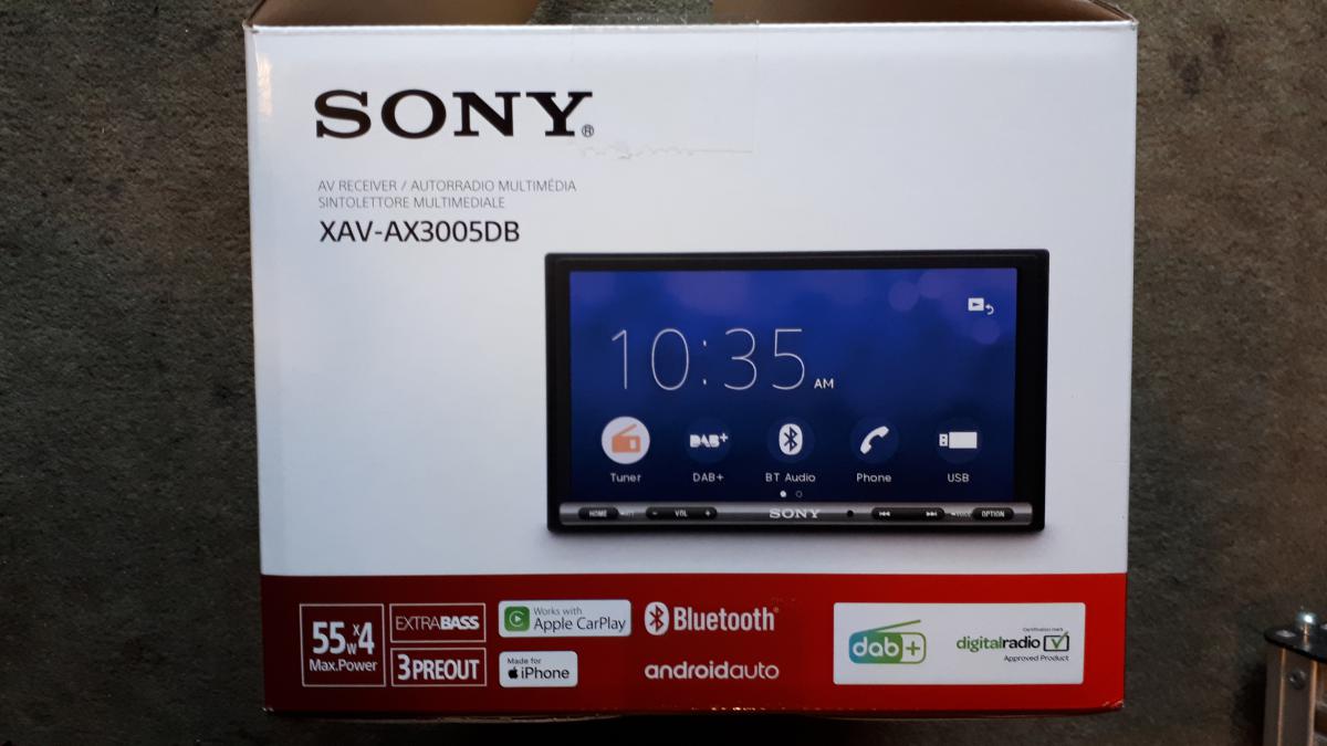

A new MyGig from Chrysler was £2,400. In the end I replaced it with a Sony but it wasn't an easy swap. You need an adapter for the dash facia, an adaptor for the wiring harness, and an adaptor for the steering wheel controls. Mine is an SRT Design and they have a Boston Amplifier. I had it fitted professionally but even they had four goes to get it right. The canbus wouldn't recognise it and it wouldn't see the amp. They sorted it eventually, cost me £600 including fitting.
