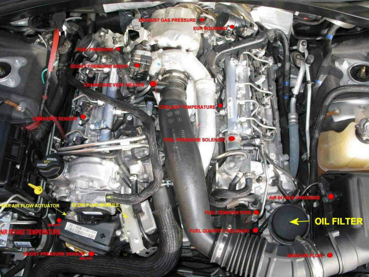

The Engine Coolant Temperature (ECT) sensor is quite cheap, available from your local parts store, and is an easy swap (ten minutes). See if it works... it did for me.
Open the hood, remove the plastic cover and the sensor is on the top of the right bank about half way down... see pic below.

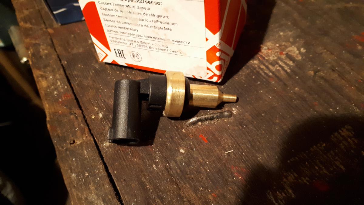

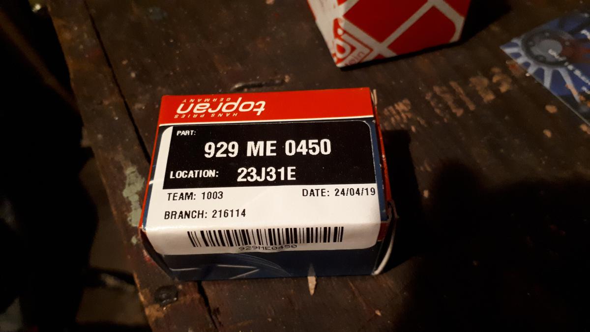

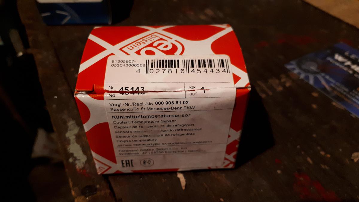

I actually bought two, one from www.gsfcarparts.com and one from www.wheelsmotorfactors.com
The part number from GSF is 000 905 61 02
The part number from Wheels is 929 ME 0450.
I'll try attaching some pics.
