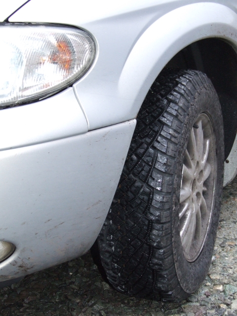

I switched to General Grabber AT 215/65R16 tyres 22,000 miles ago and they still have at least 7mm of tread left. They wear evenly across the tyre at 36psi and no noticeable change better or worse in fuel economy or noise. They perform absolutely brilliantly on wet roads and I will never fit anything else on my Voyager.
