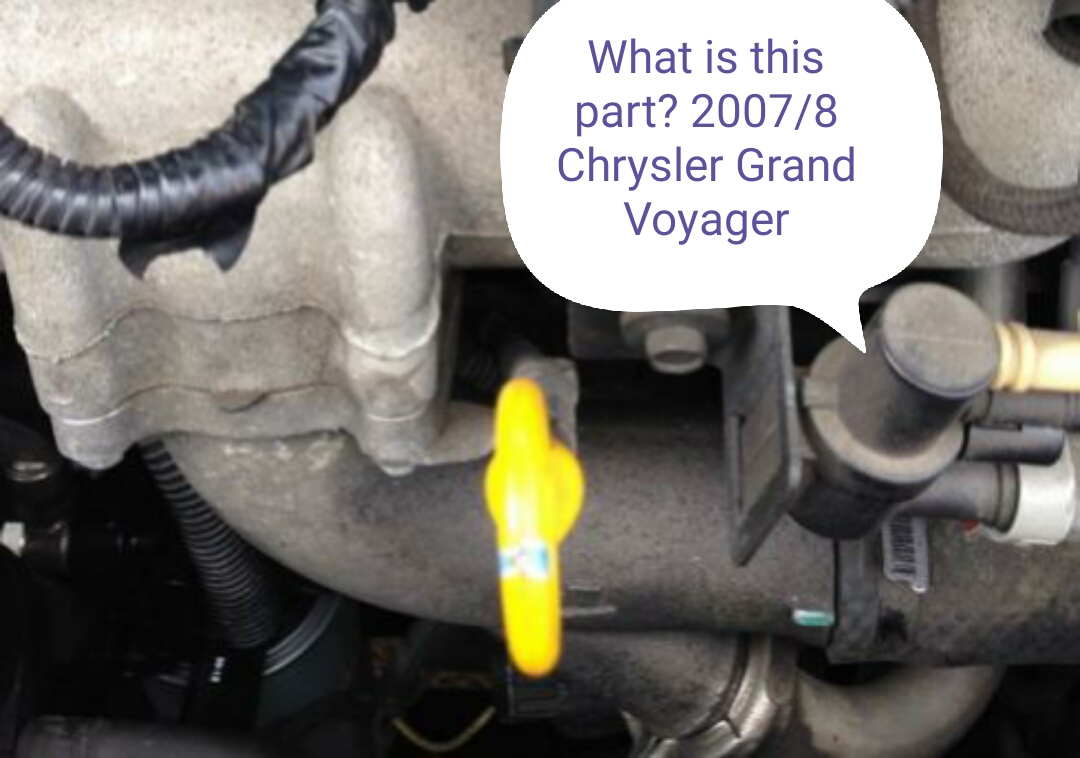

0 gordy Posted April 12, 2020 Report Share Posted April 12, 2020 Now I've 2 answers here as I'm a little confused at mo. Either turbo wastegate actuator supply vacuum valve (better name somewhere). Or EGR operating supply vacuum valve. I'm sure first one is correct as someone on here said there only £28 from main stealer. Quote Link to comment Share on other sites More sharing options...
0 Paul78 Posted April 13, 2020 Author Report Share Posted April 13, 2020 Thanks for that, a guy told me it was the egr vacuum control solenoid. Would this cause the power to be flat above 40/45 mph? I know she's a big heavy old thing, but with a 2.8 I would think it should have a bit more grunt. This is my first CGV. Very happy with it, and so comfortable Quote Link to comment Share on other sites More sharing options...
0 gordy Posted April 13, 2020 Report Share Posted April 13, 2020 There's a picture of it somewhere that was on here. I'll have a look tonight.. Quote Link to comment Share on other sites More sharing options...
0 QinteQ Posted April 13, 2020 Report Share Posted April 13, 2020 Year ? 04-07 or 07 present ? http://www.jeepchryslerparts.co.uk/shop/product/3597/egr-vacuum-solenoid-vm-motori.html Quote Link to comment Share on other sites More sharing options...
0 Paul78 Posted April 13, 2020 Author Report Share Posted April 13, 2020 It has a 08 plate Quote Link to comment Share on other sites More sharing options...
0 QinteQ Posted April 13, 2020 Report Share Posted April 13, 2020 The one I sent you is the URL for a 2.8 CHRYSLER GRAND VOYAGER RT 2008-2011. You will have your VIN number from which you will find your exact build date info. Gordy is usually right on 'oily-bits'. Check before you commit my friend. Quote Link to comment Share on other sites More sharing options...
0 gordy Posted April 16, 2020 Report Share Posted April 16, 2020 Price dosen't seem to be anywhere near £28. Earlier one must be cheaper. Quote Link to comment Share on other sites More sharing options...
0 QinteQ Posted April 16, 2020 Report Share Posted April 16, 2020 You are always gonna pay more for Mopar/VM Motori part number. £20 or £80 and it's 'parts darts' on it fixing your problem because existing part was never tested.. Scrappies options I imagine are all closed. No ones going anywhere so you have the option of .. .. .. tome. Best of luck bud! Quote Link to comment Share on other sites More sharing options...
0 gordy Posted April 18, 2020 Report Share Posted April 18, 2020 It's this EGR that's getting me now after looking at, not it, but them. Flee-bay of course always liked Pam in that red costume. Had an idea about an electronic one and right enough that comes in at 2012 on. There's one which is just a diaphram in its flying saucer case on a mount, must be a cassing missing surely. Then there's the all singing dancing one, reduced in price, must be, £66. Singing one sports the full housing, diaphram in place with valve inside housing. And there's more, there's another actuator, from the one fitted in my wee Panda it operates the choke plate.Quiet a buy at £66 if it suits your car. Quote Link to comment Share on other sites More sharing options...
