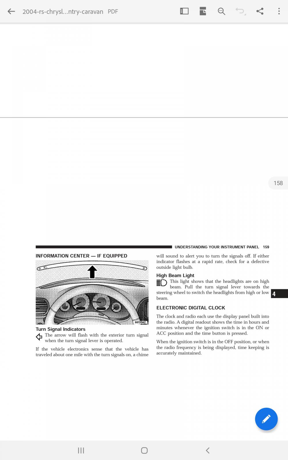

luminova11 Posted February 6, 2020 Report Share Posted February 6, 2020 Before I start dismantling the instrument cluster, does anyone know how to access the bulbs for the turn signals and high beam in the unit above the main instrument cluster on those vans equipped with the information center. Many thanks in advance Quote Link to comment Share on other sites More sharing options...
0 03GVCRD Posted February 6, 2020 Report Share Posted February 6, 2020 Yes, it's very simple. The upper cluster is a unit in itself and fitted with clips. You just need to gently prise it out. There is one multiplug to take out and the bulbs are a simple twist fit. Quote Link to comment Share on other sites More sharing options...
0 RichardM Posted February 6, 2020 Report Share Posted February 6, 2020 From the manual (basically as above but the Yanks are quite verbose ;MESSAGE CENTERREMOVAL(1) Disconnect and isolate the battery negative cable.(2) Using a trim stick (special tool #C-4755) or equivalent, gently pry up on the front side of the message center and lift out of instrument panel opening.(3) Disconnect the wire connector from the back of message center.(4) Remove message center from vehicle. NOTE: If the message center lamp needs replacing, twist out defective bulb socket and replace with a known good bulb and socket.INSTALLATION(1) Connect the wiring connector to message center.(2) Place message center in position on instrument panel and firmly snap into place.(3) Connect battery negative cable.Ta Da ! Quote Link to comment Share on other sites More sharing options...
