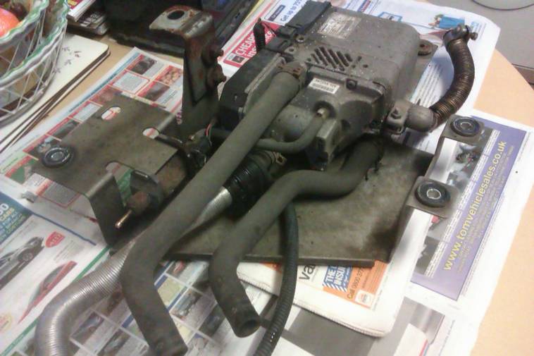

0 gordy Posted January 30, 2020 Report Share Posted January 30, 2020 Here's a picture of the heater thats below and the hoses. So is leak from heater or pipes that go up to engine. If heater its Goosed. Quote Link to comment Share on other sites More sharing options...

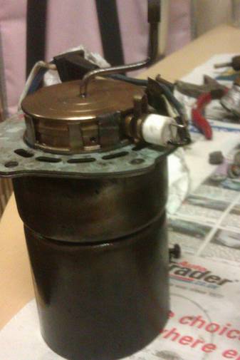

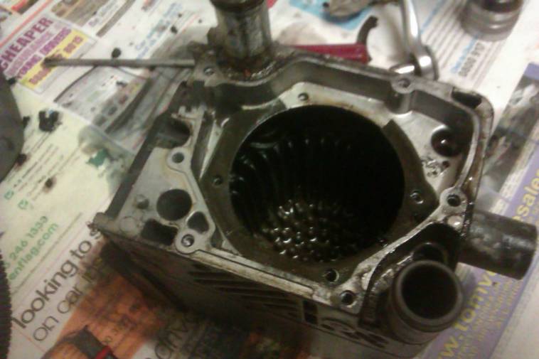

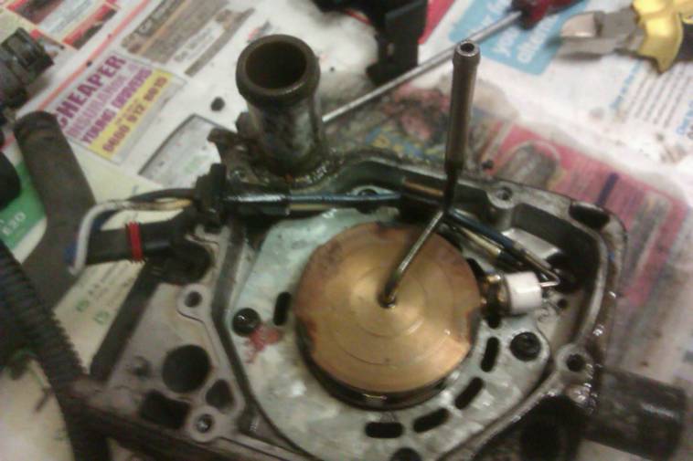

0 gordy Posted February 6, 2020 Report Share Posted February 6, 2020 Here's the inside spagetti if interested. There is a printed circuit board in there as well. In the case of mine the heat transfer chamber was fractured, that's the ribbed chamber. Quote Link to comment Share on other sites More sharing options...
0 QinteQ Posted February 6, 2020 Report Share Posted February 6, 2020 Thanks for the graphics, they always speak a thousand words. Fracture in a chamber, that's a proper sod, hope you can effect a repair. Webasto's are major boost for a great big 3 litre cold lump of engine and cheaper MPG in the winter. Must say it's the first fracture I've heard of from anyone or from posts here and elsewhere. Quote Link to comment Share on other sites More sharing options...
