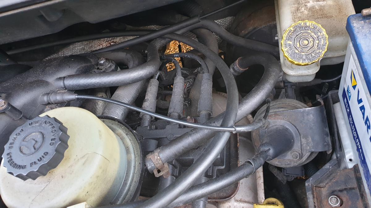

Hi, we have a 3.3 petrol, the cruise control failed whilst driving through France in a similar way to ypost-2992-0-12466400-1579435739_thumb.jpgours.
The cruise control works on a vacuum system, there is a small vacuum pipe attached to the manifold that becomes brittle and cracks over time (see pic). We fixed ours with a straw until we could do it properly, it worked although not 100%.
Hopefully yours is as simple.
Good luck.
