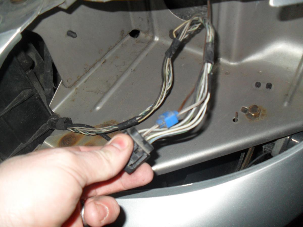

An update to my problem:
Managed to change the broken connector but the lights were still not working.
Had a mess around with the wiring and managed to get the side light and indicator working on the drivers side but still no headlight. These have since gone again which makes me think it could be a problem with the wiring or an earth?
Anyway had a good look and noticed that on the passenger side wiring there is the blue plastic clip (shown in the picture) which as one of the wires running through it to the connector and then a brown cable (possibly used as some kind of earth?) coming out of it and this runs across the car to the drivers side lights where it runs into another blue plastic clip.
Is this wire standard on this vehicle or does it look like it was added by the previous owner??
Also any ideas as to whether this is providing an earth or doing some other function?
Im hoping someone has some ideas as it is really starting to get me down now!
