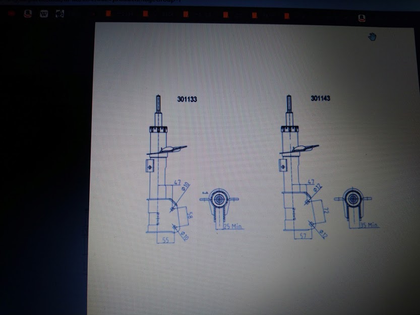

the trouble is many after market suppliers only list one part top cover all three, this includes big names like Sachs and Bilstein. I was supplied Sachs only to find the jaws at the bottom of the damper were too narrow to accept the beefier hub carrier found on the 2.0. Further checks for the bolt holes were spaced differently to allow for a different camber and the bolt holes are M12 on the 2.0 and M10 on the other versions. Hopefully the attached picture from KYB explains the differences, but I could not find their version of the 2.0 anywhere.
