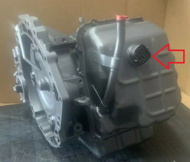

Today i have found where i think the chirp is coming from, under the battery is a set of cables plugged in to a foil covered bit on the end of the gearbox... (Please see the attached picture of what i mean). Can someone please tell me what is inside here and is this likely to be my issue?
if not, anyone else got / had this issue and resolved it?
