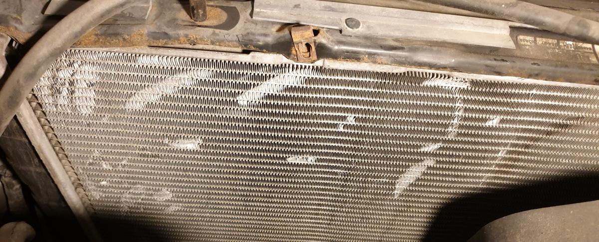

Thank you for the prompt response Penguin, having thought about it we have been travelling through Spain over the last few years sometimes at 40C + so not surprising I guess, I was just surprised at what I found.
I have replaced the said fan with a new (old) one and everything is back to normal with not too much damage to the radiator. See pic.
Thanks
Graeme
