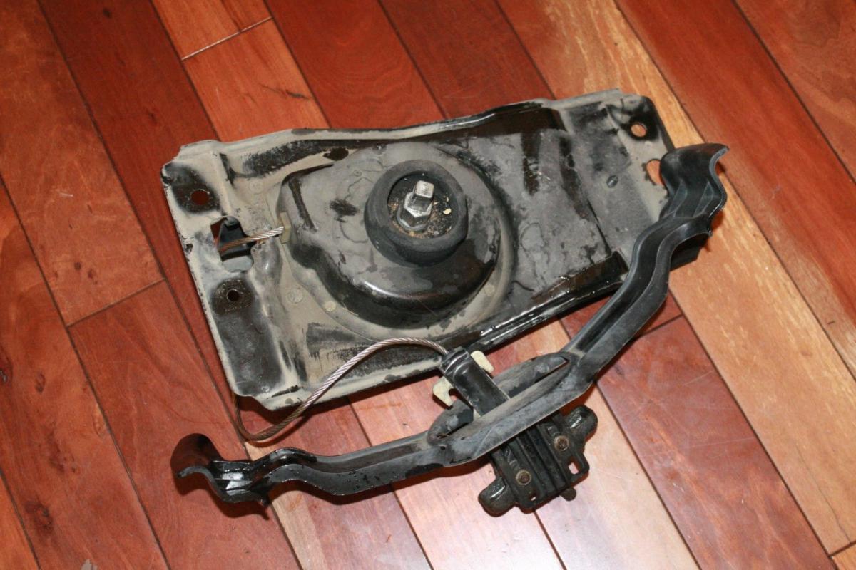

I have the stow n go spare tire stowaway...under the front seats]
Appears all the variants of this system have problems. Mine has the two safety hooks which would not release. Had to borrow an m.o.t  pit and use a 2ft bar to gain access between the tire casing and body floor, after managing a 3'' drop just enough to see the hooks and depress them allowing me to winch down.
. The hooks will work by hand only, Before I part the two halves does anyone know if there is a spring within?
