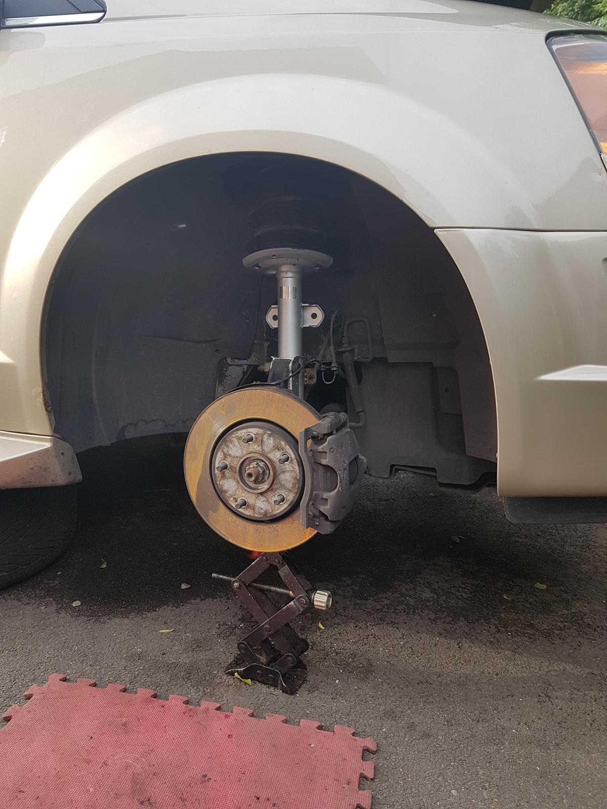

- lift, secure
- remove wheel
- undo top link bolt (need a 18mm spanner at the back to lock it then turn nut with 18mm socket, otherwise it will just turn)
- remove four clips holding the top plastic tray where wipers are (no need of removing wipers)
- undo 21mm bottom shocks bolts, and live one in just to support when undo top.
- put small jack under the suspension arms so they wont drop without shocks and cause that shaft will pop out from the gear box.

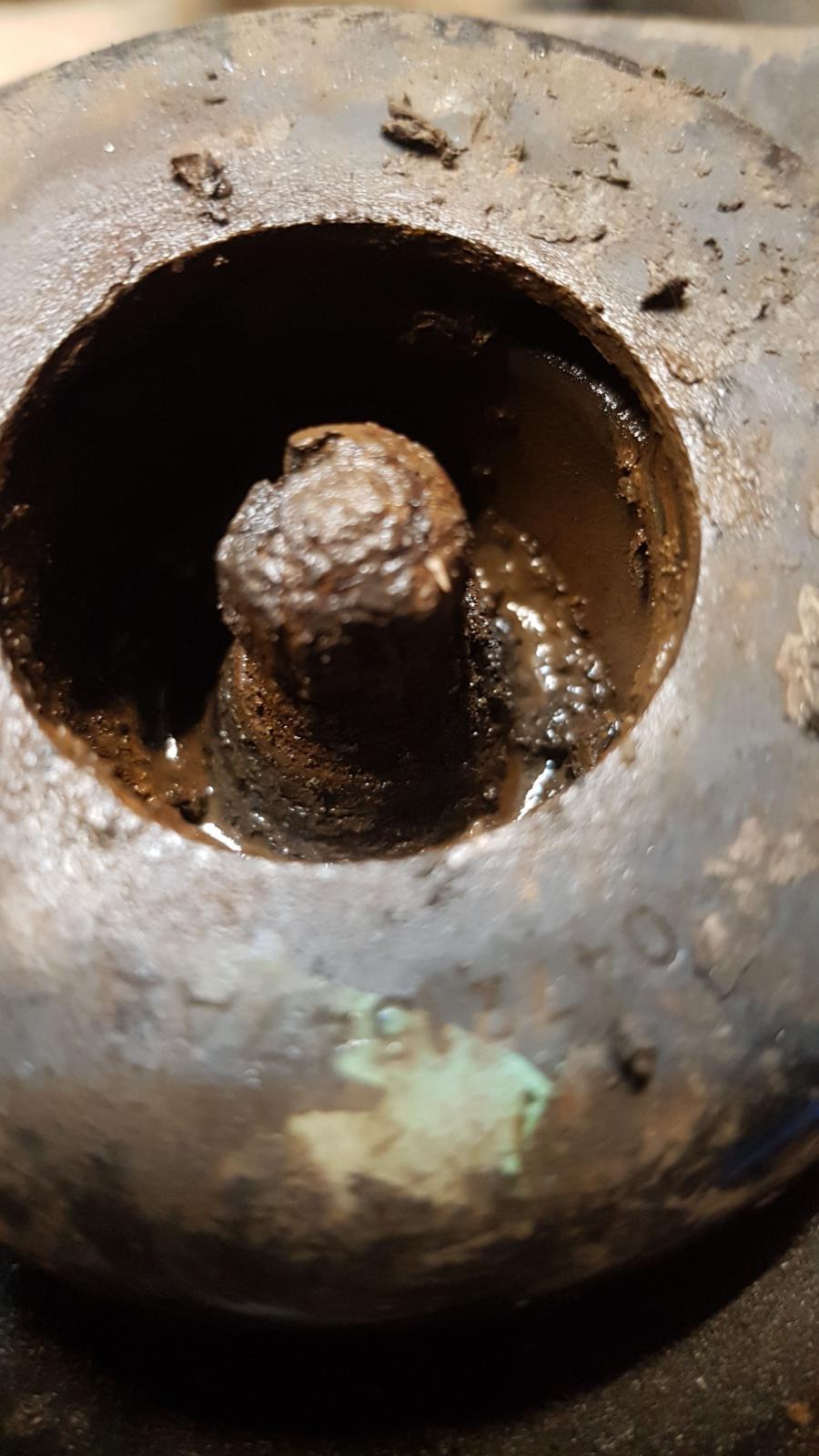

Not this time, on both sides top bolt was rusted so bad that it cracked and none of the sockets could not take her out.

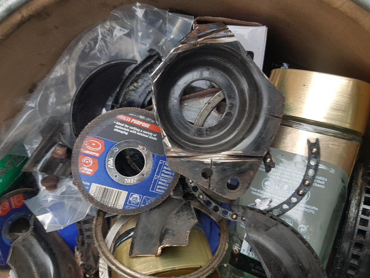

Ended up cutting the top mounts like a pizza, in order to get spring, dust cover, and top and bottom rubbers out.
