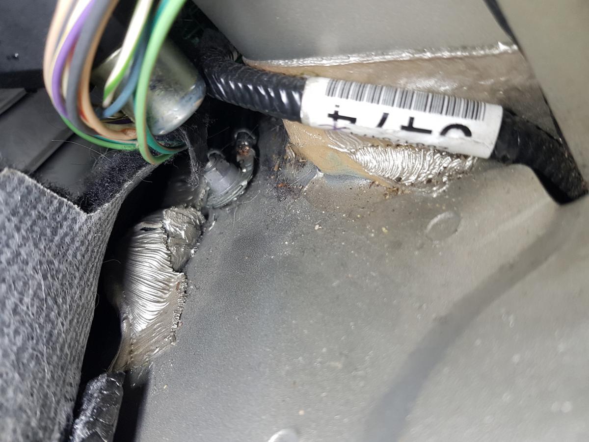

karmannski Posted February 25, 2019 Report Share Posted February 25, 2019 Both sliding doors do not open manual only from the remote or cabin buttons (!) Now in the cold morning like today 1-2 Celsius both started to work 1st thing in the morning. So I assume this is more electrical issue than mechanical. Before I will take the panels off, or the doors can anyone share their experience with similar issue? Thanks a lot. Quote Link to comment Share on other sites More sharing options...
0 karmannski Posted March 1, 2019 Author Report Share Posted March 1, 2019 Ok It seams to work after reseting of the module. To reset it you need to disconect positive lead from batterry for 10min. I hava also checked IOD fuse (M13) and give it a clean. Aparemtly it is the software failour and it happens now anf them. bignev and Rich 2 Quote Link to comment Share on other sites More sharing options...
0 karmannski Posted March 4, 2019 Author Report Share Posted March 4, 2019 Problem is coming back. Sadly I will have to do further inspection Has anyone got access to the diagrams for central locking? My MOT will expire in 3 weeks and I need to get this done ASAP . Quote Link to comment Share on other sites More sharing options...
0 karmannski Posted March 6, 2019 Author Report Share Posted March 6, 2019 (edited) Hi all, I managed to fix the issue and hope that it will help some of you in the future to save some stress and money. The problem was bad ground wire G300 that lives under the carpet next to the B pillars on each side of the car. You must remove plastic covers and lift the carpet, undo the wire and give it a good clean. I found this video for similar problem, that might help you to picture it. https://www.youtube.com/watch?v=ZSEAVnWP5X0 Hopefully this is it and I wont have this problem any more. Edited March 6, 2019 by karmannski Rich, bignev and Taffy 3 Quote Link to comment Share on other sites More sharing options...
