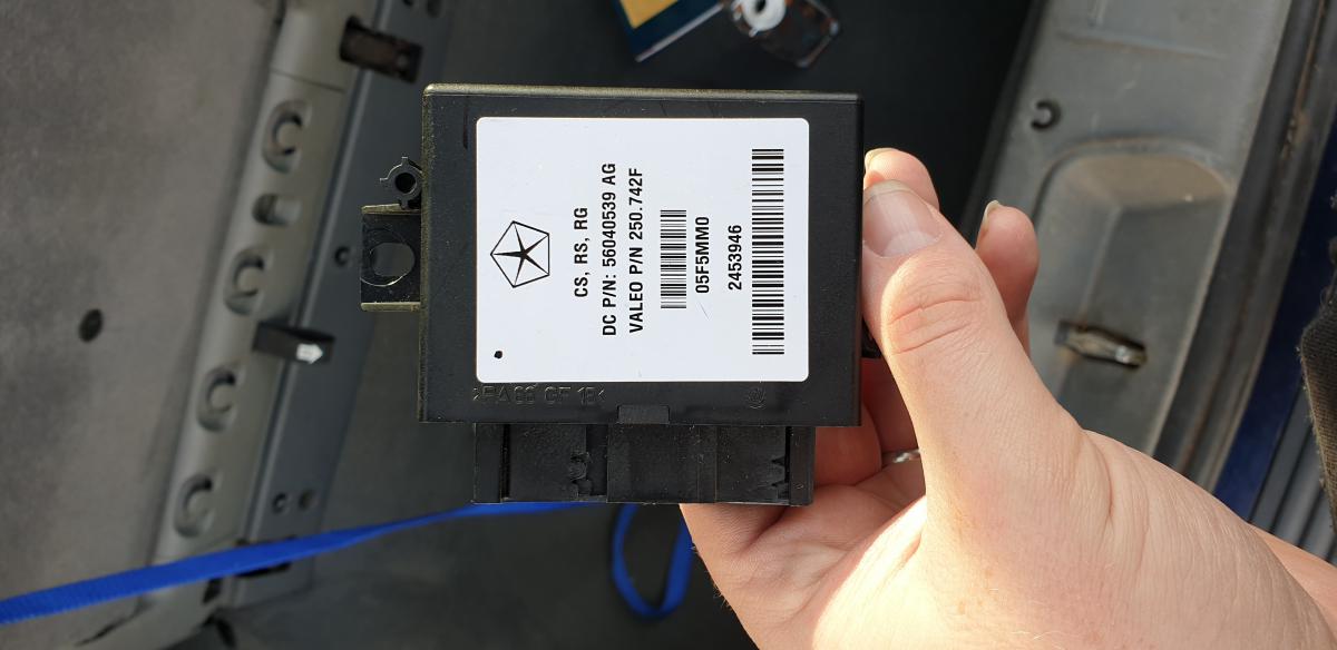

ametcalfe1989 Posted February 24, 2019 Report Share Posted February 24, 2019 Okay so after buying and having a good search of my MK4 2.8CRD GV I have found my PDC module just chilling on its lonesome in the boot. Anybody know where I plug it back in? Part pictured below Quote Link to comment Share on other sites More sharing options...
0 ametcalfe1989 Posted February 25, 2019 Author Report Share Posted February 25, 2019 Found the answer! https://www.bodyshopbusiness.com/chrysler-park-assist-system-service-and-repair/ Quote Link to comment Share on other sites More sharing options...
0 QinteQ Posted February 24, 2019 Report Share Posted February 24, 2019 No idea but it's rear bumper and don't REM seeing it anywhere obvious. So rear 1/4 panel RHS loom I assume. It's a 'self correcting unit unless it's goosed altogether so should put an error in the EVIC. Quote Link to comment Share on other sites More sharing options...
0 ametcalfe1989 Posted February 24, 2019 Author Report Share Posted February 24, 2019 Yeah, without the PDC the Evac is saying "service park assist" I'll pull up the carpet tomorrow and have a closer look QinteQ 1 Quote Link to comment Share on other sites More sharing options...
0 BumBle02 Posted February 25, 2019 Report Share Posted February 25, 2019 My parking box was in the rear n/s panel where the jack up bits are stored. ametcalfe1989 1 Quote Link to comment Share on other sites More sharing options...
0 ametcalfe1989 Posted February 26, 2019 Author Report Share Posted February 26, 2019 Thank you BumBle02 I'll have a play on the weekend Quote Link to comment Share on other sites More sharing options...
