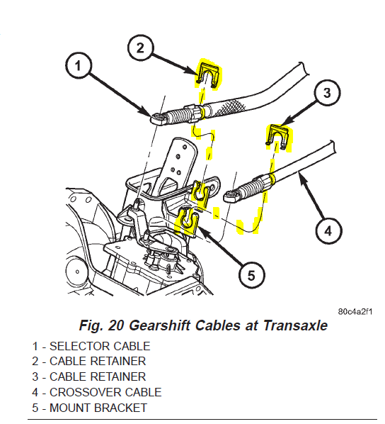

The next part was to pop off the connectors at the ends of the two gear cables - straightforward with a large flat head screwdriver.
Removing the clips from the gear change cable sleeves was a little more tricky. It was a bit of a reach, but not too bad with the aid of a pair of mole grips, some WD40 and a long flathead screw driver.

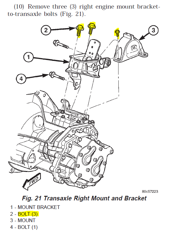

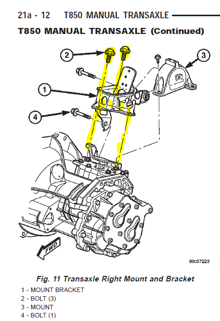

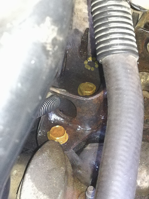

The next step says to 'Remove three (3) right engine mount bracket-to-transaxle bolts'.....  I'm not entirely sure which bolts they mean.  I've highlighted the ones I think they mean on the attached diagram and photo.
Are these the right ones?
If so, I can just about get an 18mm socket on the front 2, but couldn't really get a good enough purchase on them to loosen them before I gave up for the night.  I couldn't even get a socket on the rear-most bolt...  I've highlighted the front 2 bolts in the photo and put dots where the rear most bolt sits - through the hole in the bracket.
Are they the right bolts, and do I really have to remove the bracket?  Would the gearbox drop okay if I left the bracket on?

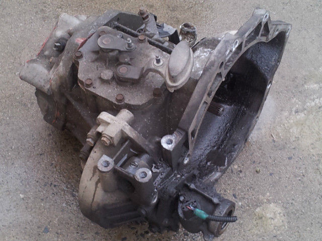

I had a bit of a brainwave - I decided to look on ebay for 2.5CRD gearboxes and found the attached photo.
It shows the orientation of the 3 bolts that need to be undone.
From that, I had another look at the diagram. I realised that I had misidentified the 3 bolts - the diagram only shows 2 of the bolts, but if you trace the dotted line down from one of them, it splits into 2 locations.
I think I'll use a length of old exhaust pipe to direct some air from a heat gun onto the bolts and then use another length on my ratchet to get a bit more torque onto the offending bolts.

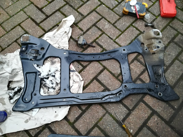

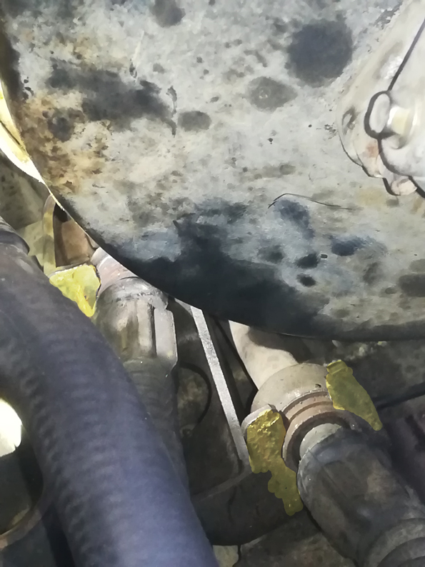

I hadn't realised exactly what the 'cradle plate' was but have now started to take it off.  One of the bolts at the back doesn't seem to have an accessible nut and the 2 bolts right at the back corners seem very tight - I retired back to the house without freeing off those 3 bolts.  Oh, I did find that there was a lot of play in the rear of the left suspension control arm, so I've ordered a set of replacement bushes for both sides.

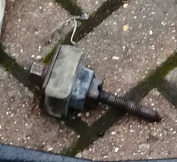

Does anyone know the correct name for the rectangular rubber and metal mount that goes in the back corners of the cradle plate, and more importantly, where to get a replacement?  The one on the photo is okay.  The other one looks like it wasn't put back properly by the last person who had it off and it's a bit mangled where it fits up inside the body.
