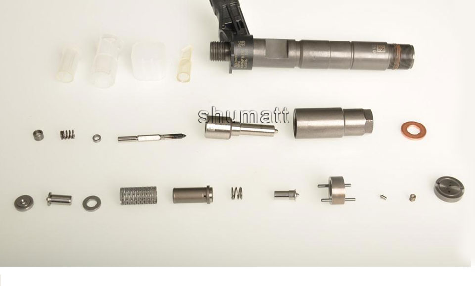

0 karmannski Posted October 30, 2018 Author Report Share Posted October 30, 2018 Head Gasket sorted out. Head tested&skimed £50 (cash in hand) , new 1.2mm head gasket for £30 from eBayOld bolts as they do not stretch and are spot on 15.5cm long every single one and there is TEN of them not 18 or 16. Anyway, now I need to clean all injectors as not efficient and has got low performance and need new washers as one of them leaks. Engine is taping and smoke comes out. lessuth 1 Quote Link to comment Share on other sites More sharing options...
