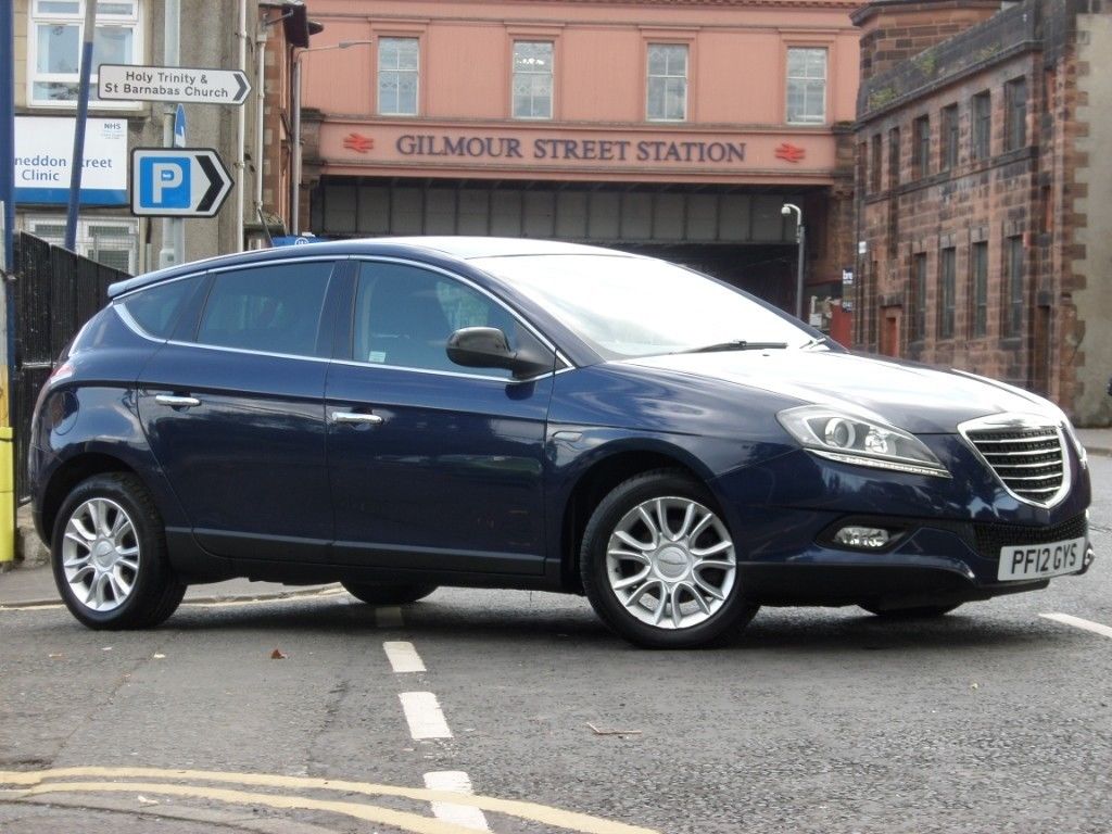

TJB Posted October 8, 2018 Report Share Posted October 8, 2018 I'm going to have a look at this Delta on Wednesday. 2012, 1 owner, 37k and allegedly, 7 stamps in the service book. It's a 1.4 Multi-air SE. Anything I need to be on the lookout for? Any help gratefully received Quote Link to comment Share on other sites More sharing options...
0 MikeyRules Posted October 8, 2018 Report Share Posted October 8, 2018 Check for any suspension knocks and bangs. These are prone to snapping a spring at this age. The multiair unit can have problems too, but Nello would be best to advise on that one as he's been through the replacement avenue. He would be best to advise on symptoms to look for. Other than that they're pretty good. Obviously with it being a 6 year old car check the general wear and tear, cambelt,pulleys and water pump should have been changed by now too. So if that hasn't been done factor that into your negotiations. TJB 1 Quote Link to comment Share on other sites More sharing options...

0 TJB Posted October 10, 2018 Author Report Share Posted October 10, 2018 Well, I missed out on the blue one, sold yesterday. I may go and have a look at the auto. Thanks for all the advice. Quote Link to comment Share on other sites More sharing options...
