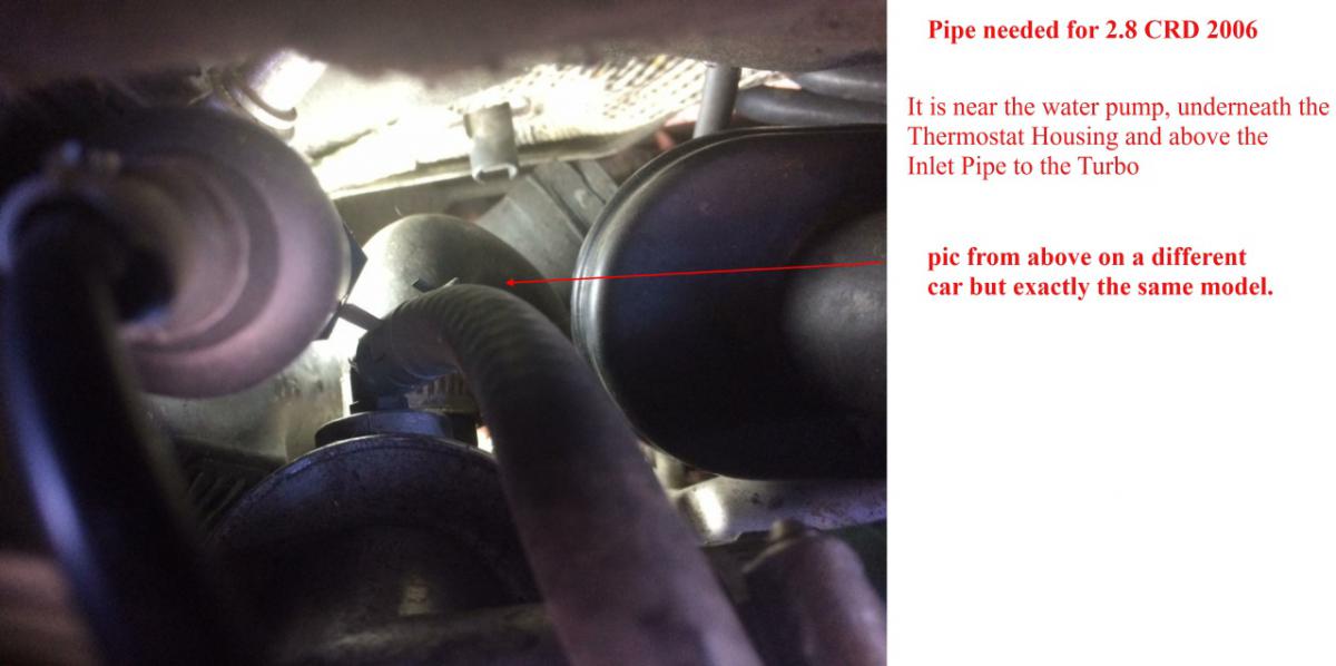

Looking underneath with the engine running, above the turbo, but below the thermostat there is a 2" plastic pipe with an odd "U" shaped channel in it, sticking out thru a heat shield in the bulkhead.
There are a couple of photos in the newbie forum under the same topic (Excessive Leak dated 13th June) showing the location of this pipe
Occasionally water can be seen spitting out of this pipe but nowhere near the quantity I'm losing in total.

HI Sentech-
Long shot here but i wondered how you got the pic from above of the hose below the thermostat?
This seems to have split on mine but i cant get any sort of access from above to it.
Its on a ramp so might be able to do the fix from below but just thought id see.
I also need to get the Inlet Pipe to the Turbo removed. Ive got the bottom clip off but wondering now if it will left out from above?
If you can remember anything about it it would be really helpful.
