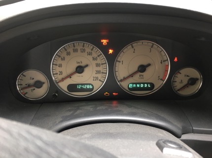

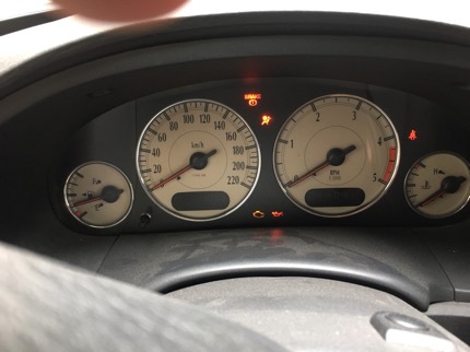

frogland Posted June 24, 2018 Report Share Posted June 24, 2018 When i switch the headlights on the mileage counter and gear position lights on the cluster switch off, the center console lights are also affected. Has anybody else encountered this problem ? voyager 2006 2,8 crd Quote Link to comment Share on other sites More sharing options...
0 andyb2000 Posted June 24, 2018 Report Share Posted June 24, 2018 Hi there,Yep, it's the dimmer control, should be a slider beside the light control switch beside the door. Try turning it up to full brightness and they should come back on as they've just gone very dim.If not then the variable control may be damaged and forcing it all to low brightness. bignev 1 Quote Link to comment Share on other sites More sharing options...
0 frogland Posted June 25, 2018 Author Report Share Posted June 25, 2018 It was the dimmer control thanks a lot Andy. andyb2000 and bignev 2 Quote Link to comment Share on other sites More sharing options...
