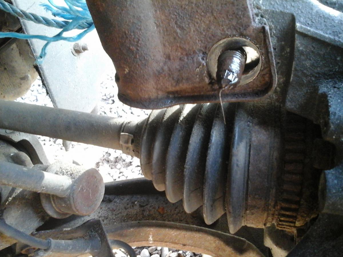

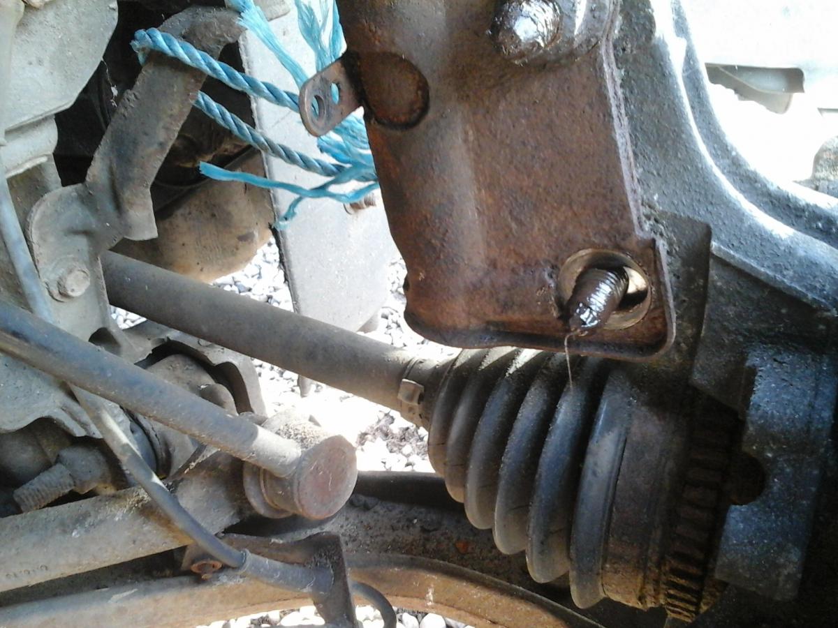

0 gordy Posted April 16, 2018 Report Share Posted April 16, 2018 Ah finally found the picture of when my front strut was removed. Its the bottom hole on strut that's elongated for adjustment to camber. Quote Link to comment Share on other sites More sharing options...
