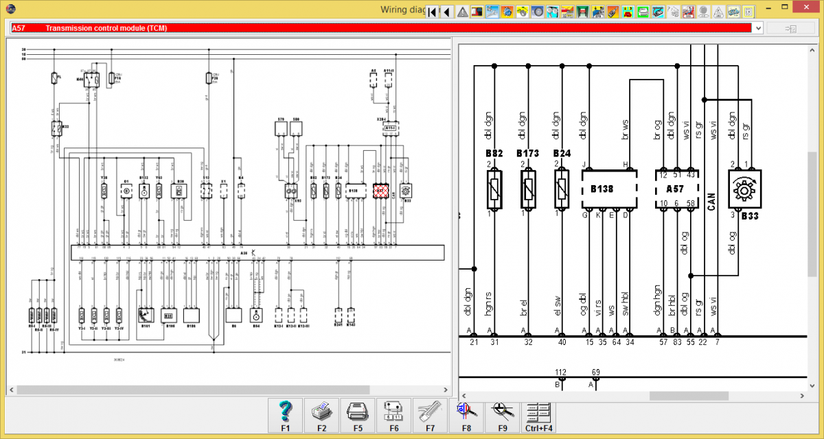

The TCM being replaced what's left is to check the wiring to it.
A57 in the picture attached is the TCM.
Hope it helps.

Thanks for the picture.
