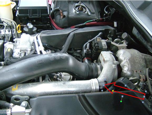

I know theres some rubber intercooler pipes as well that run down the front of the engine to the intercooler, plus the metal one that exits the turbo (see photo) It might be worth checking these, as the metal one especially has a habit of leaking air.
  On 4/13/2018 at 3:02 PM, Briscoe76 said:
HI Sean.
hi Briscoe,
i have done what you said and removed the metal pipe from the turbo which goes to the resonator box and found a light green o-ring at the turbo end which seemed to be in good nick.
as i looked at the other end that fits onto the resonator box i had only three quarters of a black o-ring (hensce air escape i assume).
so the next question is where can i get these 2 o-rings from and is the green/black combo o-rings correct for this pipe.
at the moment i made a rubber seal to replace the black broken one to keep the car on the road and to my surprise the whistle has gone away, so i am chuffed with myself but would prefer to get the proper ones fitted if i can find them,
again thankyou very much for yor advice on this matter
I have managed to get the 2 proper o-rings from of all places a Mercedes dealership for the turbo metal pipe. I ordered a spare set aswell for a total of £20 which seems a bargain. As my home-made rubber is working great i havent bothered fitting them yet..
