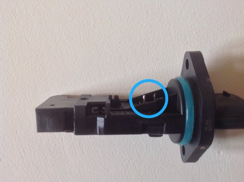

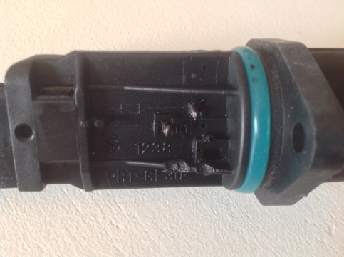

frogland Posted February 22, 2018 Report Share Posted February 22, 2018 (edited) This is what my MAF sensor looks like,it seems as though there should be a wire here.Some examples of the same sensor i've seen do have a wire and some don't,does it make a difference ? (and how do i delete a post i've put this up twice ) Edited February 22, 2018 by frogland Quote Link to comment Share on other sites More sharing options...
0 mikebh8 Posted February 23, 2018 Report Share Posted February 23, 2018 I didn't have time to take mine apart to post a picture but it should have a wire there with an electronic component, I can't say if it is resistor or not.If you search it online you could see it. Hope it helps. frogland 1 Quote Link to comment Share on other sites More sharing options...
0 QinteQ Posted February 23, 2018 Report Share Posted February 23, 2018 Its missing a replaceable resistor get a UK one to be safe or just put a 20p resistor in. Best of luck. frogland 1 Quote Link to comment Share on other sites More sharing options...

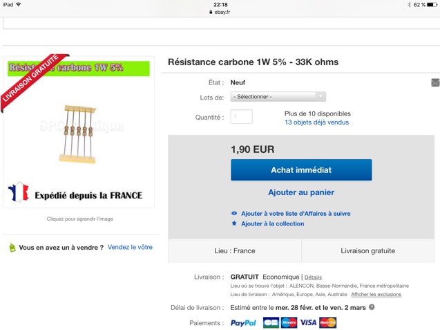

0 frogland Posted February 24, 2018 Author Report Share Posted February 24, 2018 ok i've ordered some some of these to do the button mod ,can i use the same one in the MAF sensor ?Im curious to know what happened to the original resistor ? i didn't find it in the turbo or the air inlet. Quote Link to comment Share on other sites More sharing options...
0 QinteQ Posted February 24, 2018 Report Share Posted February 24, 2018 The buttonMOD needs 1/2 or even 1W simple carbon film type resistor @ 33. What the MAF needs I've no idea what should be in it, doesn't it come populated - anyone here know the value ? Quote Link to comment Share on other sites More sharing options...
0 frogland Posted February 24, 2018 Author Report Share Posted February 24, 2018 for the button mod -33k ohms ?? Quote Link to comment Share on other sites More sharing options...

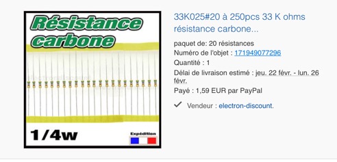

0 QinteQ Posted February 24, 2018 Report Share Posted February 24, 2018 The buttonMOD needs 1/2 or even 1W simple carbon film type resistor @ 33 your pic shows 1/4 W not 1/2 or 1 watt my friend. Quote Link to comment Share on other sites More sharing options...
0 frogland Posted February 24, 2018 Author Report Share Posted February 24, 2018 ok QinteQ im going to order some 1w resistors i just wanted to sure it was 33000 ohms that was needed and not 33 ohms or 330 ohms. Quote Link to comment Share on other sites More sharing options...
0 QinteQ Posted February 24, 2018 Report Share Posted February 24, 2018 My fault the proper way to express it is 33K [33,000] Ohm Metal Film Resistor @ 0.5W. NOTE : Not the 1/4W in your thumb. frogland 1 Quote Link to comment Share on other sites More sharing options...
frogland
