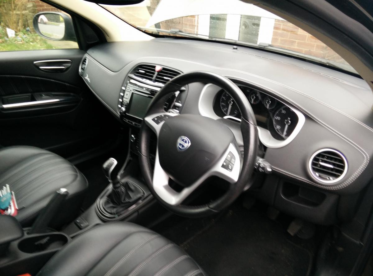

Well thought I'd start a new thread now I've actually got the car home and have started doing some rebranding and modifications to track the progress and help others who fancy going down this route.
As bought/standard:

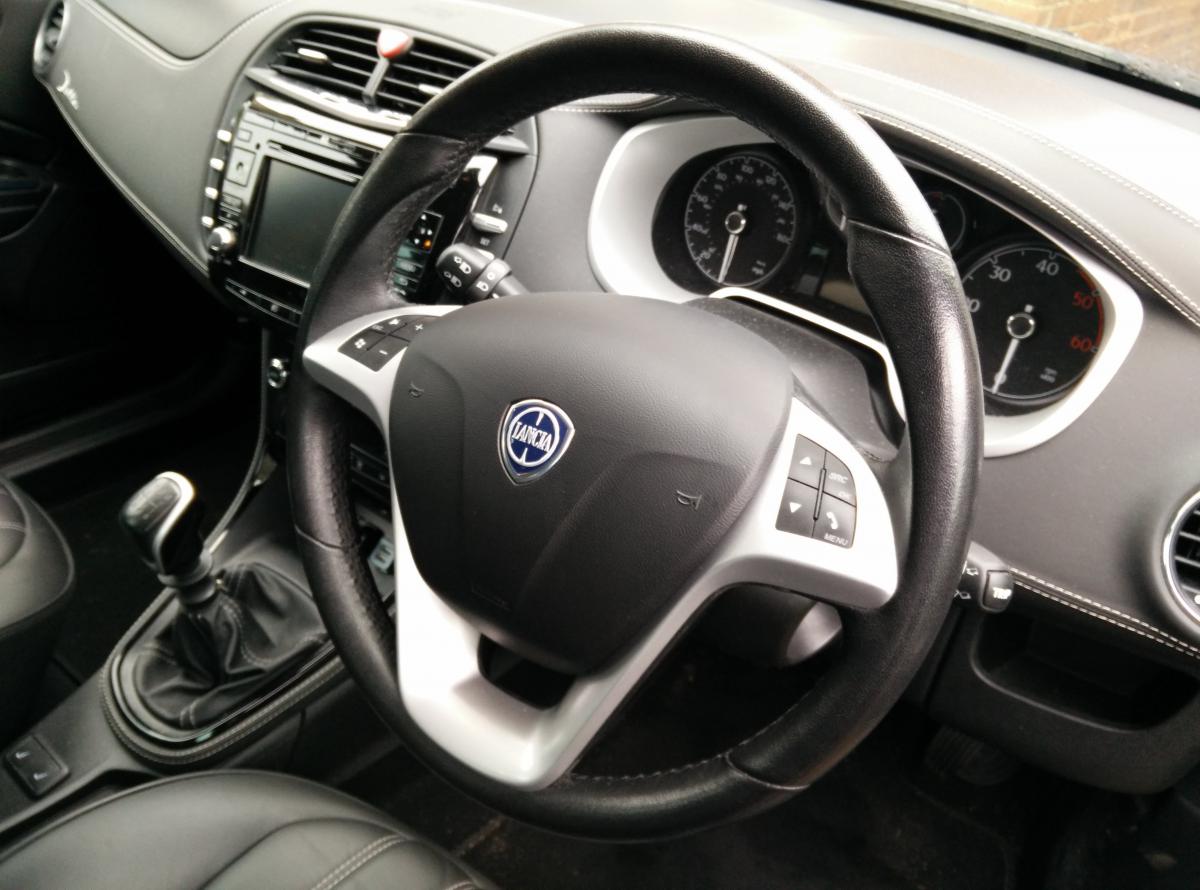

New Momo Design black grill:
I'm now waiting on a new Lancia Airbag, Sill plates, rear badge and 4 hub caps, ah and a set of mats...

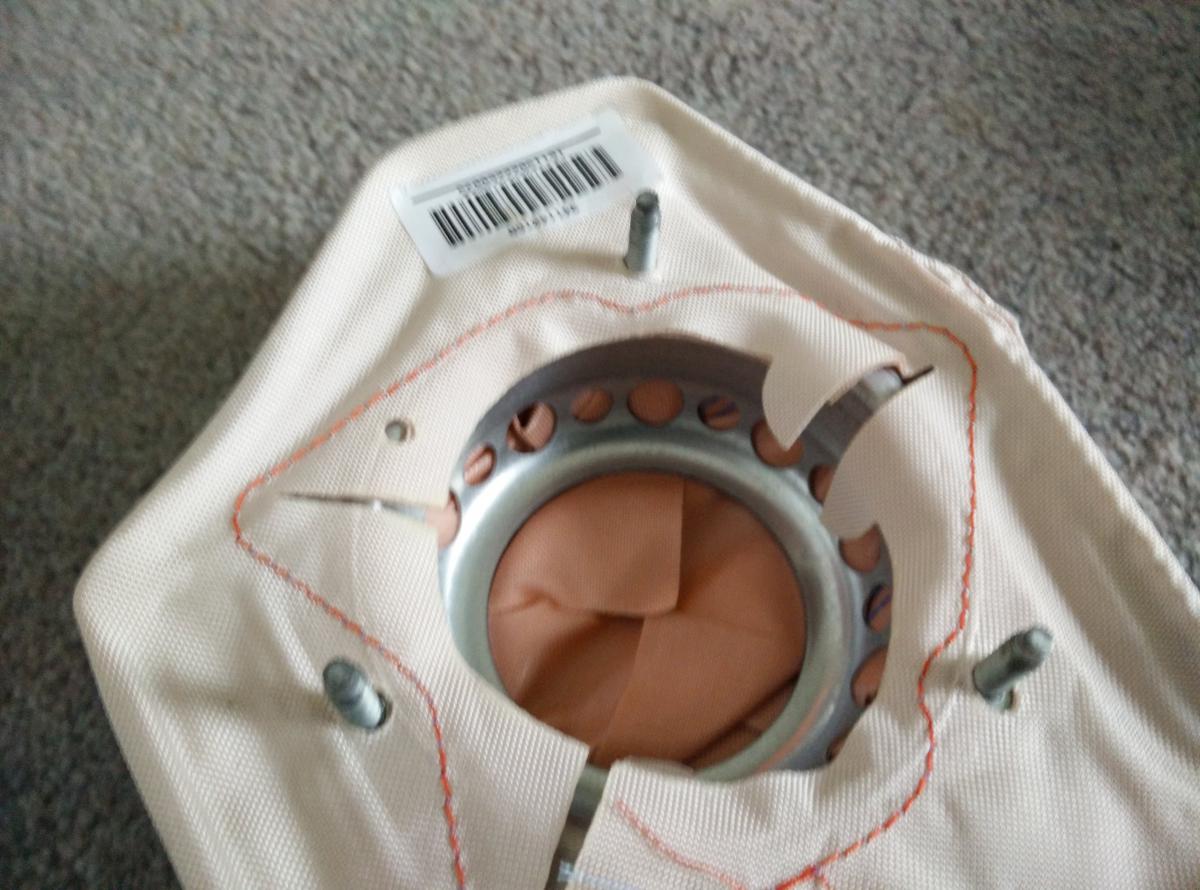

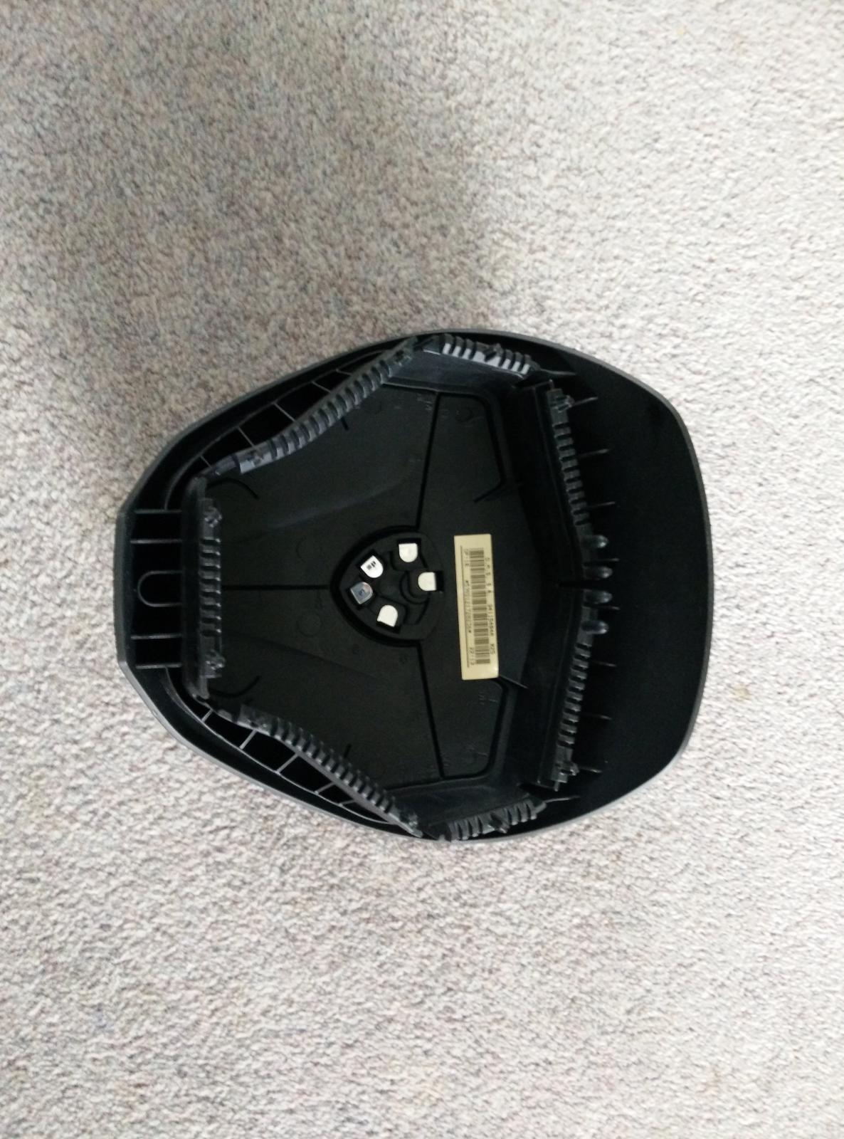

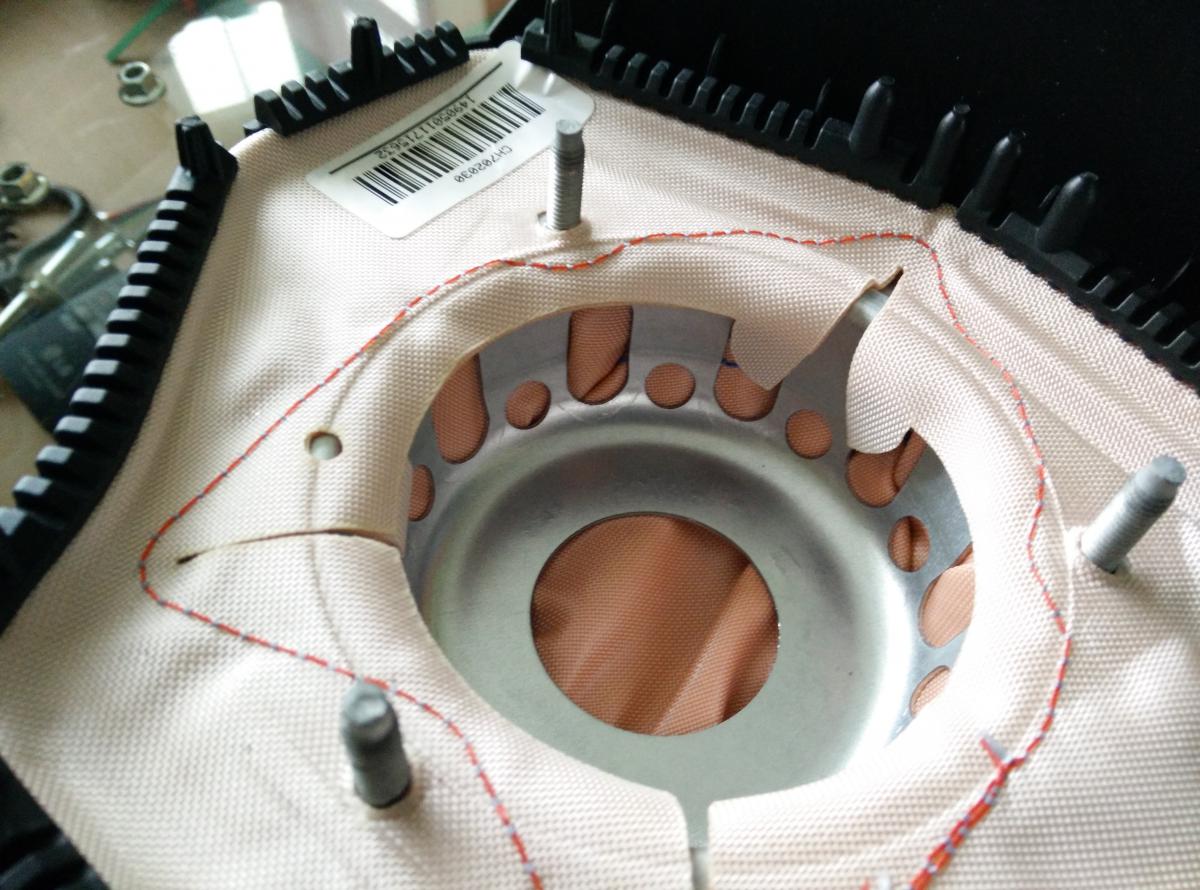

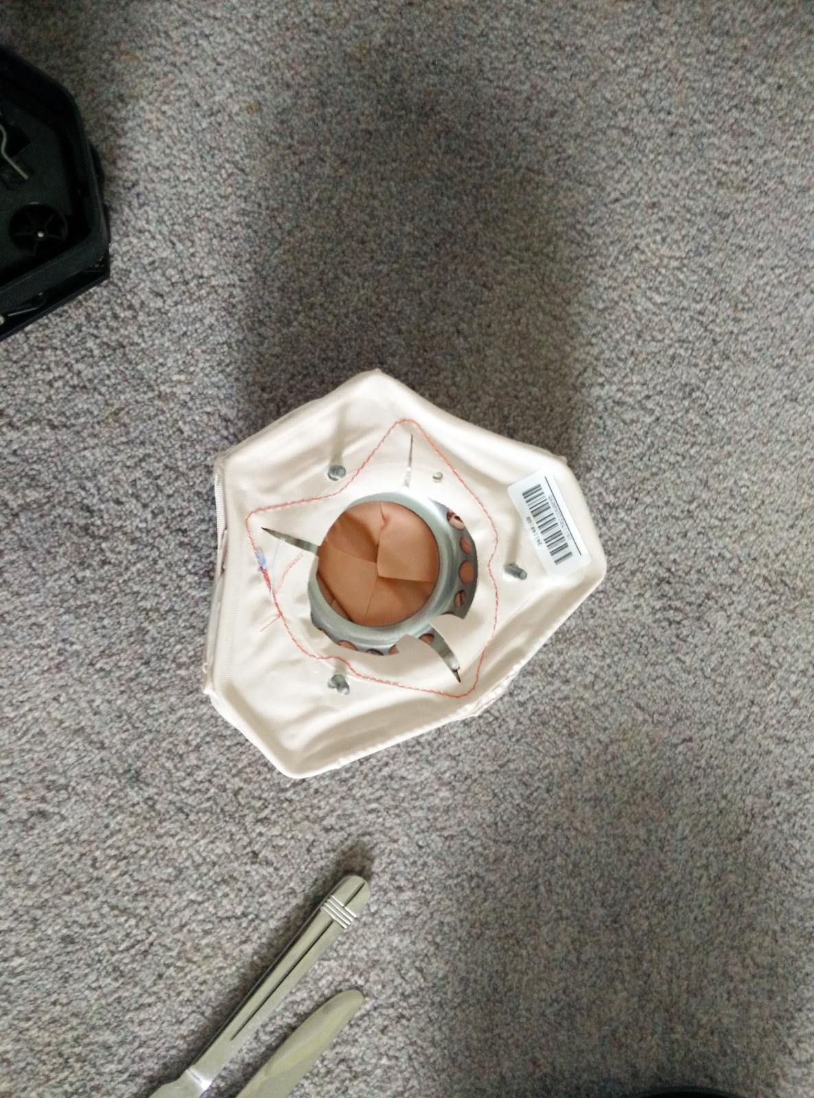

To clarify the first pic is the ypsilon bag, as you can see it has two sizes of round holes in the diffuser, the second is the delta bag which is two stage and has both round and elongated holes. The cover is the lancia badged one, from the inside you can see the weakened lines that are designed to split open when the bag deploys. The outer lip of the cover rolls over the back of the bag/diffuser and then locates into holes in the horn push assembly.
