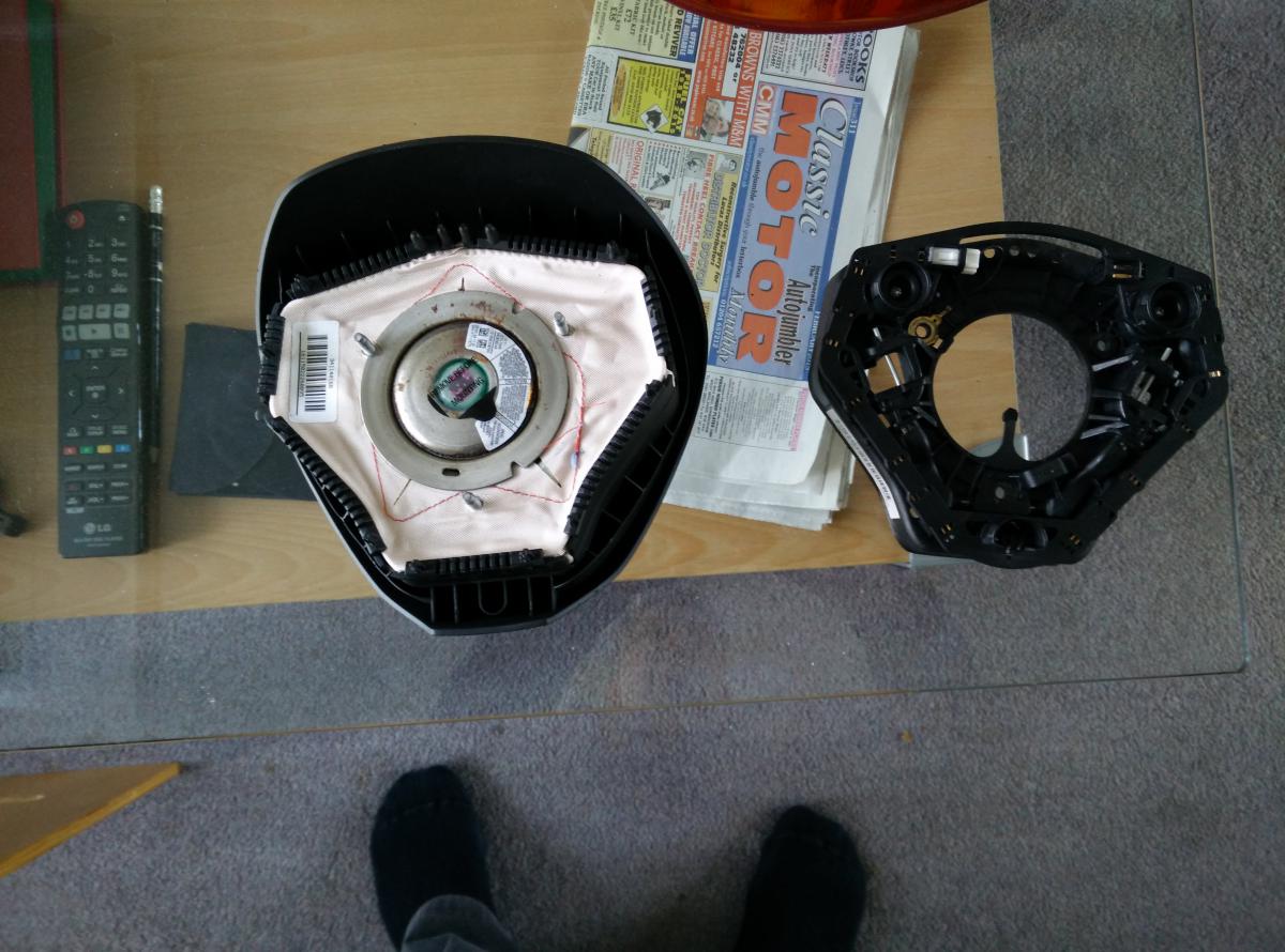

Disaster after a gargantuan struggle managed to get the airbag to release only to find that the one I have doesn't fit :-( it's absolutely identical and same manufacturer except the terminals for the centre aren't the same so back to the drawing board not sure I'll change it now as can't risk another wrong part turning up its just money poured straight down the drain
Well decided to remove the horn push unit on the new wrong airbag unit three nuts and it lifts off, and guess what you can then just lift out the bomb leaving the outer cover and airbag in one piece! Assuming that the bag/ cover are identical (I imagine they must be) this means I can just swap the front and bag (when I'm feeling brave that is.....) popping the original bomb in the middle and fitting the original horn push assembly.
Yes just need to check that the bag assembly is indeed identical with just a single or two stage bomb depending if it's ypsilon or delta, the beauty of this of it works is that the car will retain it's original bomb/gas generator. This also means that used bags aren't so risky as it will be possible to simply substitute the original explosive parts! Edited by Rossocorsa
Few things sorted, epoxied the key logo on and did the airbag scariest job ever but easy!
Took the bag off removed the horn assembly (3 nuts) and gas generator which simply lifts out to find that the inner diffuser is different to the ypsilon bag so using some dinner knives to hold the edges of the cover outwards whilst I removed both diffusers with bags attached. Careful job this as if bags unfurl when you do it you'd be stuffed as they are folded in a specific sequence so that they deploy correctly. Switched the units over and as they say in Haynes manuals assembly reverse of removal!
Anyone thinking of buying a second hand airbag from Italy should note that it is really easy to take off the horn assembly and therefore as the gas generator is loose inside ( it is just held straight by a short plastic protrusion when you reassemble) you can refit your old and known to be good generator rather than risk the second hand one, you could also swap your bag over but tbh I doubt that is necessary.
