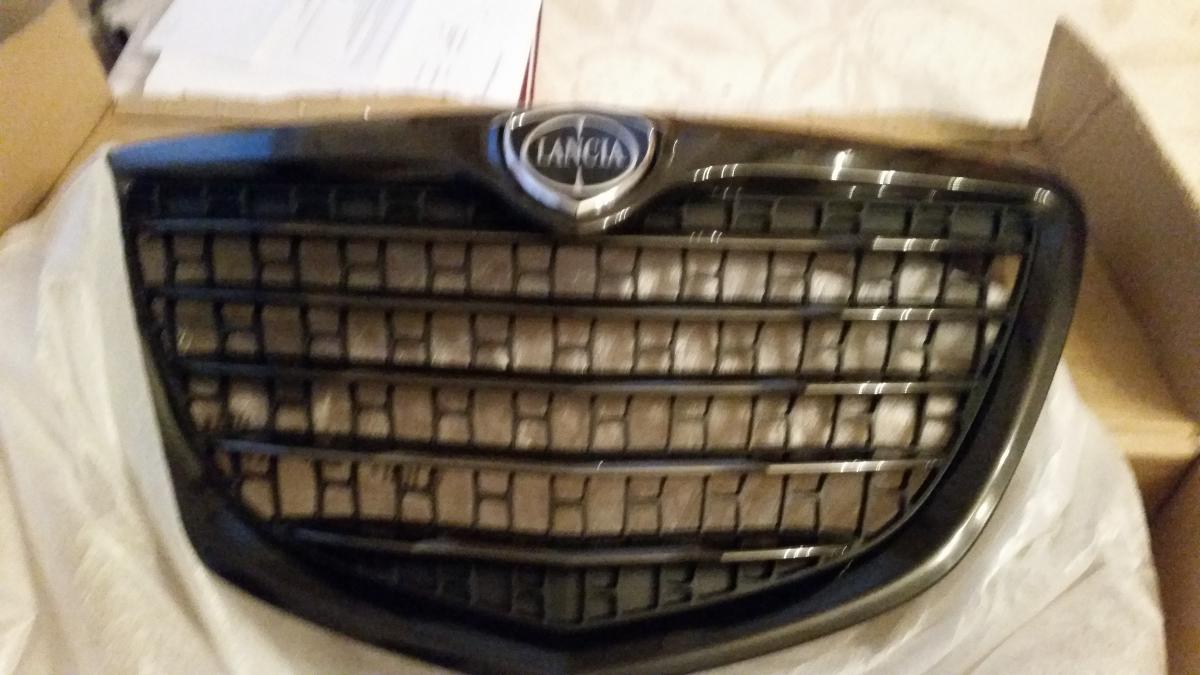

New Momo Design black grill:

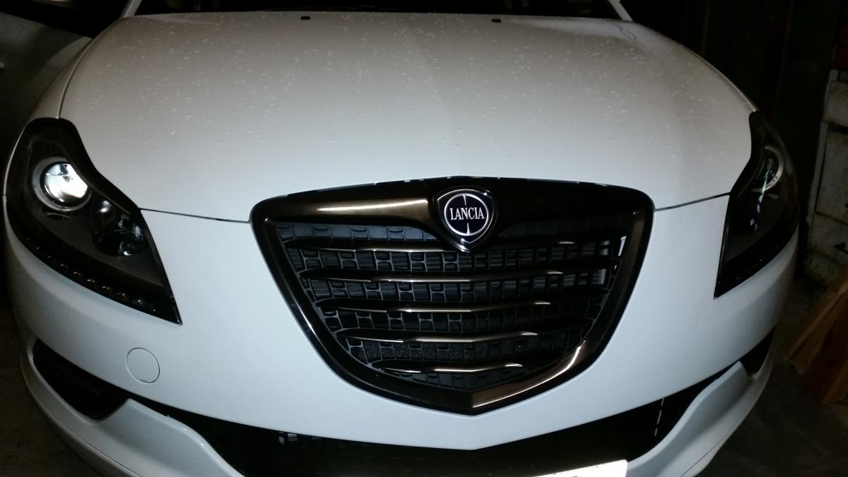

There is another Lancia Delta on the streets of Great Britain.
I cannot believe now quickly the grill arrived from Bella Italia and i just could not wait to get it fitted. So i removed the bumper as per your very good instructions Nello and fitted the new grill which looks great.
The outside of car is now complete just the inside to sort now. Still looking for an airbag but not found one cheap enough at the moment and i like the look of the Martini door sills Nello so would be grateful for any info about them.
