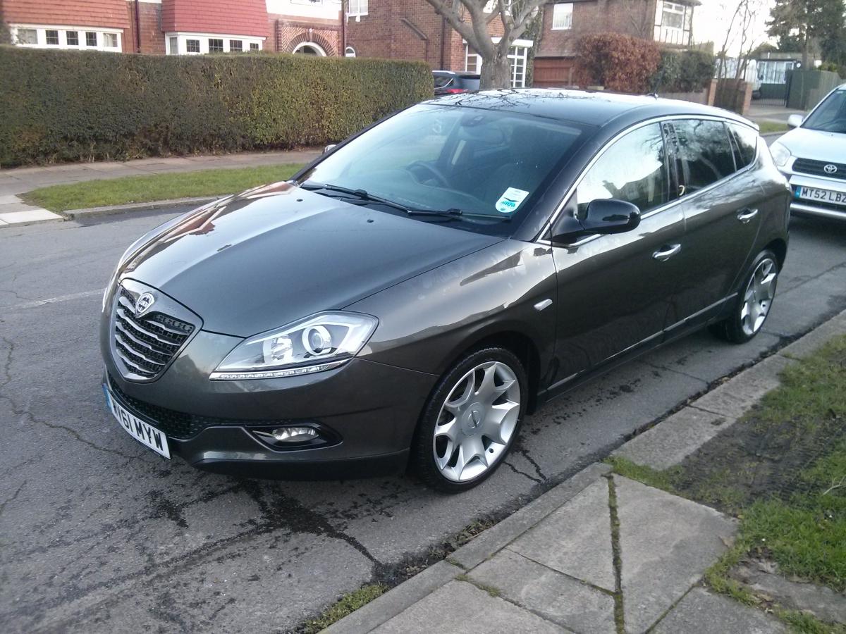

Well thought I'd start a new thread now I've actually got the car home and have started doing some rebranding and modifications to track the progress and help others who fancy going down this route.
As bought/standard:
Rear Badge removed:
Standard head unit:
New Sat Nav / DVD / TV / WI-FI /Rear view camera head unit: (I'm still waiting on this and hope to have it installed before Xmas)
New Momo Design black grill:
I'm now waiting on a new Lancia Airbag, Sill plates, rear badge and 4 hub caps, ah and a set of mats...

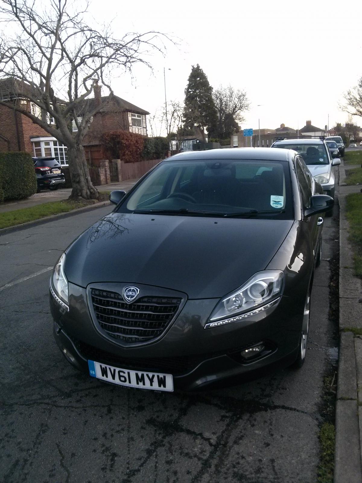

Grille fitted, went for the mikey method but I snapped off the top tabs by pushing them with a screwdriver rather than just pulling and once the top ones were off it was easy to pull the grille off. Only down side was that I broke the locating pin on the bottom of the old grille. Managed to find 9 of the eleven original clips, fiddly to detach from the remaining slither of plastic but ok. The new grille clips loosely into place and I then fitted back the metal clips that I could reach by trying to get them started by hand (not very comfortable as the clips are made of sharp thin metal) then used a flat bladed stubby screw driver to push them on fully. The near side clips were a lot more difficult to get on than the offside not sure why although it was maybe slightly more obstructed. In the end managed to get 7 clips back on but couldn't access the ones at the bottom of the grille, I didn't think it's a disaster and can't think it will dislodge or fall off. The grille looks so much better than the Chrysler one, the pointed section in the middle follows the lines of the car and makes the front look right, before with the Chrysler grille the bonnet area didn't flow properly.
Not the easiest of tasks and I've a few grazes to prove that I am a true lancista!
