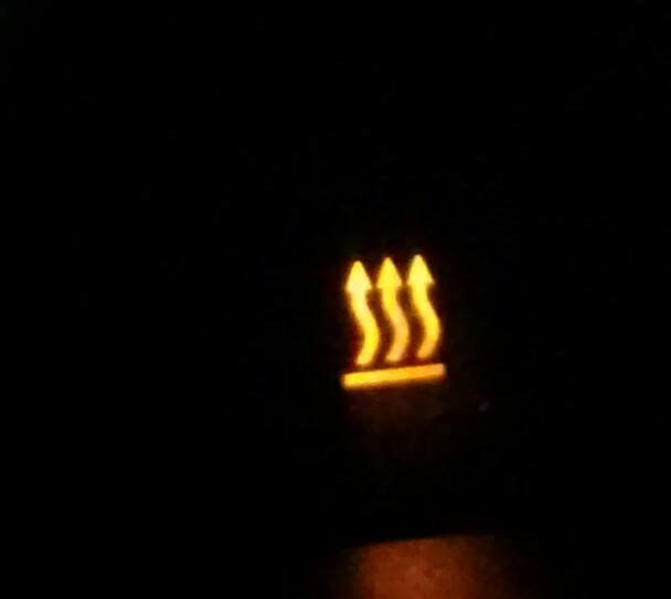

vanholy Posted November 24, 2014 Report Share Posted November 24, 2014 Hi,because i lost the manual of my Voyager , i can not identify this light on my dashboard, can you help me? Tnx Marco Quote Link to comment Share on other sites More sharing options...
0 chill6834 Posted November 24, 2014 Report Share Posted November 24, 2014 Hi,because i lost the manual of my Voyager , i can not identify this light on my dashboard, can you help me? Tnx MarcoHi Marco, this light shows when the auxiliary heater is on. the auxiliary heater uses a small amount of diesel to help heat your cabin quicker. if i remember correctly it only does this if you have at least quarter of a tank. If you turn your ignition off when this light is on you will still hear the auxiliary heater going beneath the car. regards, carl. Quote Link to comment Share on other sites More sharing options...
0 vanholy Posted November 25, 2014 Author Report Share Posted November 25, 2014 Thank you very much Carl, your help was very appreciate!! Quote Link to comment Share on other sites More sharing options...
0 QinteQ Posted November 26, 2014 Report Share Posted November 26, 2014 Webasto, lives underneath the car, pre-heats water. Money well spent. Quote Link to comment Share on other sites More sharing options...
0 QinteQ Posted November 26, 2014 Report Share Posted November 26, 2014 Workshop manual, they are almost impossible to find particularly the diesel. Quote Link to comment Share on other sites More sharing options...
