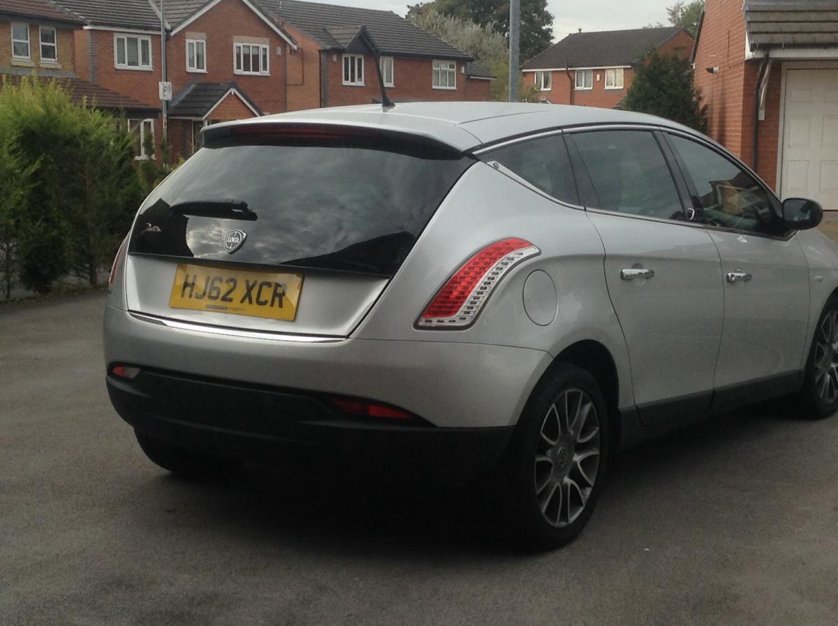

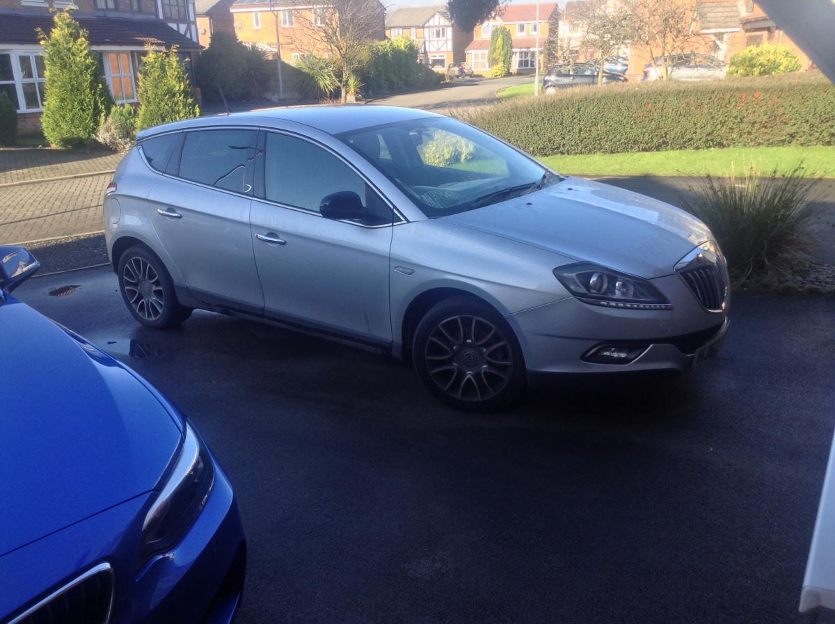

Another delta rebadge,thanks to reading your posts and nello on the wheel centres..rear badge and grille and little side badges done..
Nice one mate - good to hear. They are getting scarce now. Photos are always good  B)
Took me ages trying to get these pictures up,I'm in bury...only seen one white near me once..not many around.had a few people ask me about it since it was rebadged...kind of like the exclusivity it brings for the money it cost..

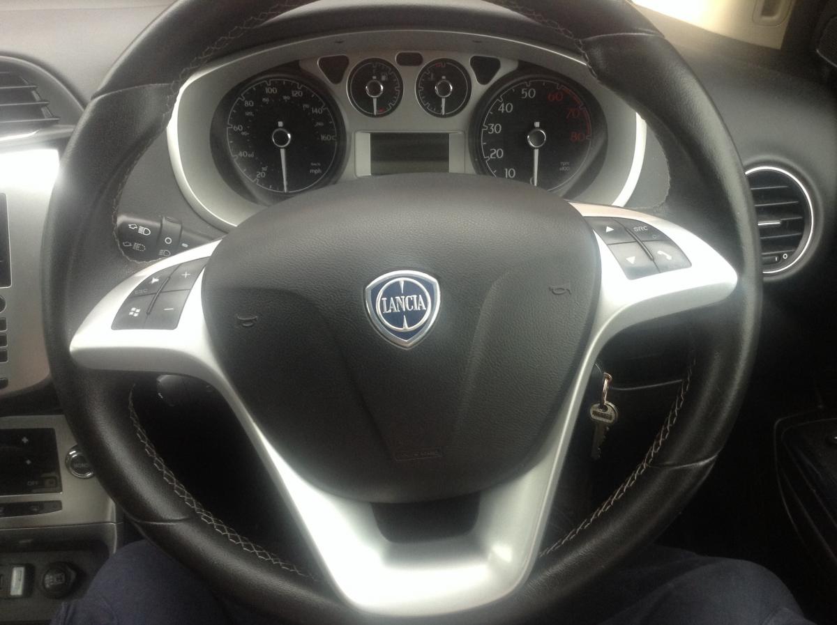

Don't know weather to go the hole Hogg and get the airbag,
It's been a great help reading all you guys posts to ,,thanks..
Looks good!
I'm in Stockport, so we probably won't cross paths on our travels unless you go to any of the car shows?
Yeah you absolutely have to change the airbag... Well for me at least it was almost more annoying than that bloody awful spread wings emblem on the tailgate! Especially as it stares you in the face every day!

Taken your advice guys and got airbag,,100 euros delivered Italian eBay,,
Nightmare to get old one off
