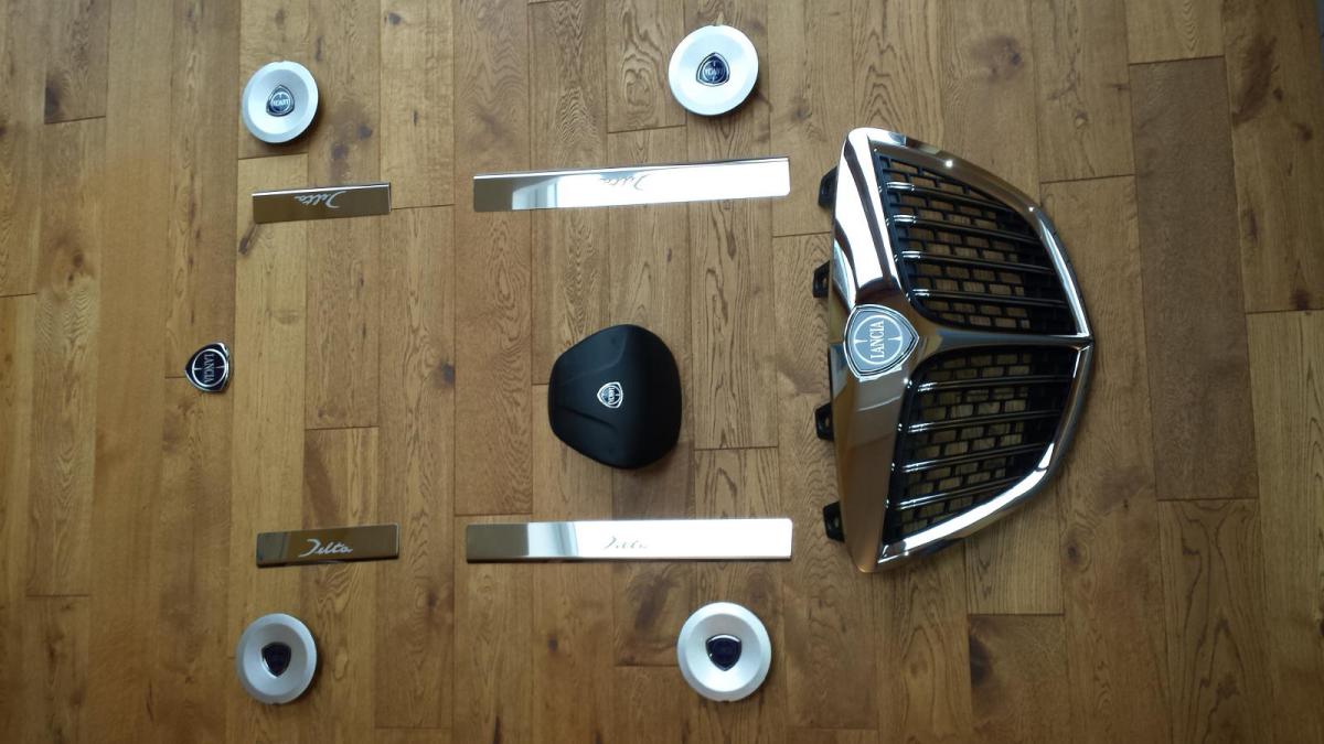

I bought my Delta as a Fiat group enthusiast and have bought a replacement Lancia front Grill along with rear badge. The alloy centres and other badging will follow!

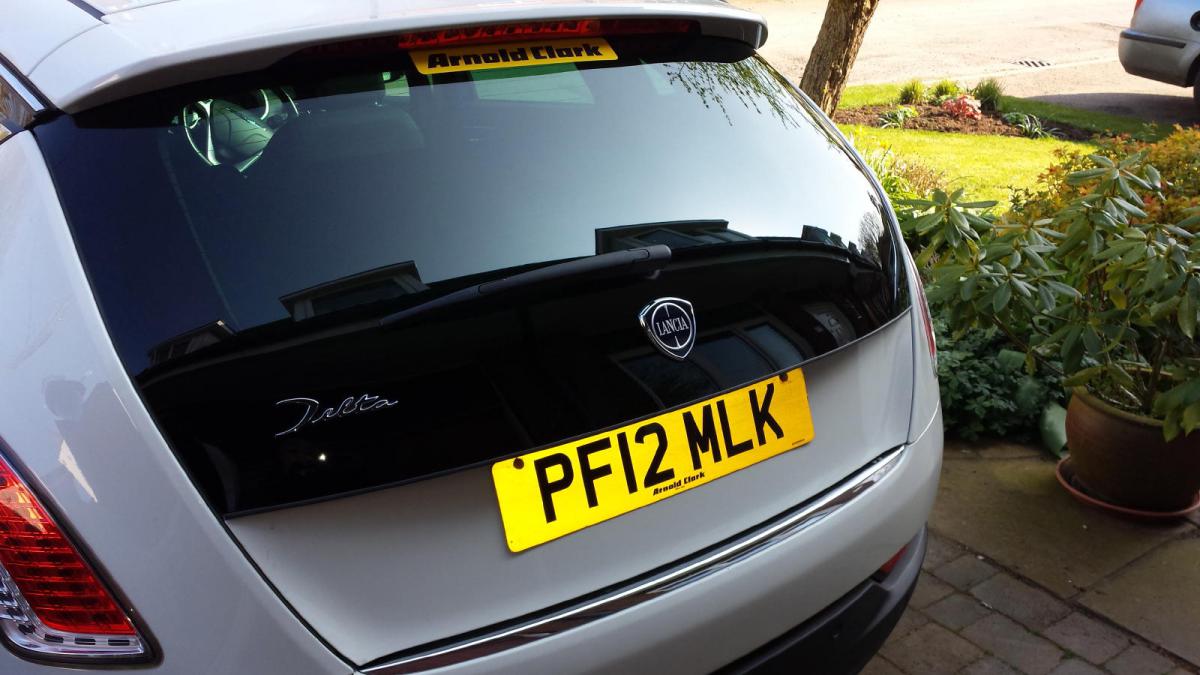

Replaced the rear easily enough - heat up the badge with a hair dryer then slide some string along to break up the adhesive. Roll off the excess with you thumb then remove anything left with sticky stuff remover. I just need to work out how to remove the front grill. There are 6 T30 Torx Star head screws along the top edge.
I think there is a fixing inside each front wheel arch to remove then a series of screws underneath the front edge under the car and the whole bumper should hopefully come off. Will confirm once I've done mine! The Grill itself is then held on to the bumper panel by 10 clips on the grill back that push on.

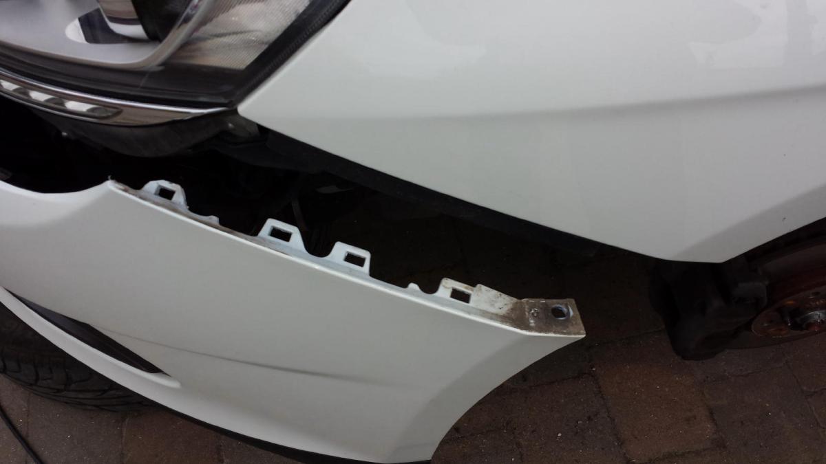

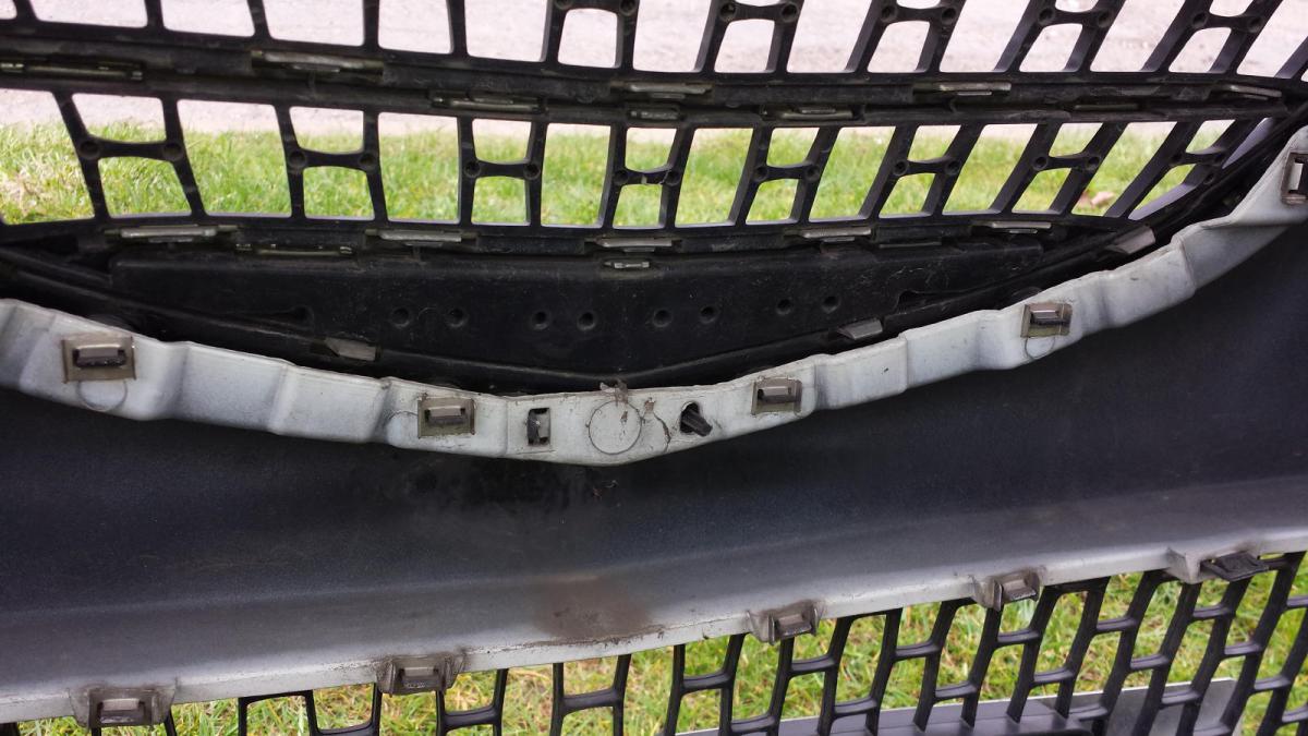

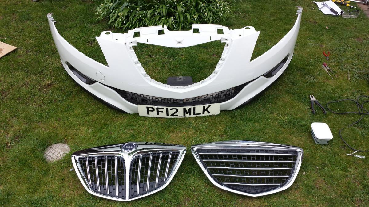

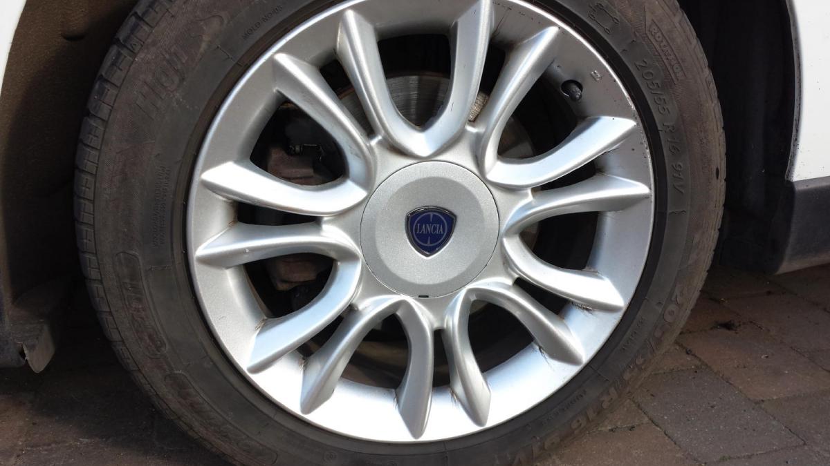

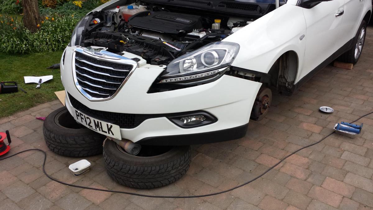

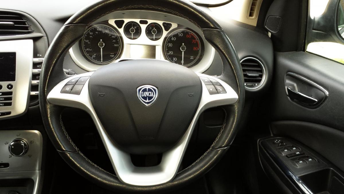

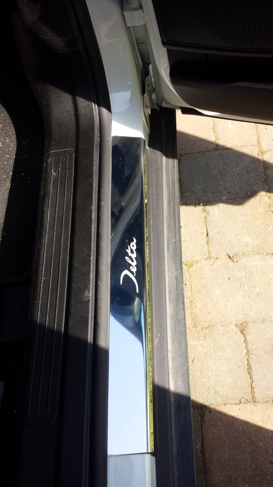

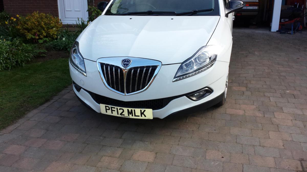

Just changed the grill on mine, a bog standard 1.4 MAir.  Also changed the wheel centres, rear badge and put on some non-OEM kick plates.  I have the airbag steering wheel centre to fit which is the next job.  Thanks to all the posts here which really helped give the confidence to do the work.  I've added a few photos.  Managed to get the old Chrysler grill off without breaking any of the plastic tangs.One thought - is it necessary to undo the bolts in the white metal joint?  These seem to just hold the outer wing to inner wing and aren't directly related to the bumper but maybe the bumper wouldn't come off without them out?  Taking these out took about half the total job time for me.  Thanks again everyone.

Great work Ian  B)  Glad the info helped another Deltisti. Where did you source your Wheel centres from?  You did well not to break any of the plastic grille tabs.
Pretty sure you do need to remove those white metal bolts to free the bumper but its been a while since I did mine. I think we may be up to about 6-8 converted cars now in the UK that I know of.
Edited by Nello
Thanks Nello,   I bought the car from Arnold Clark back in the summer last year and I asked them if they could get the Lancia badging and they said yes and quoted for all the items.  They even said there was stock of the wheel centres in the UK which seemed odd and I'm not sure if I believe this although they came quickly.  In the end I just bought the wheel centres and rear badge from them.  They said they could only supply the horizontal bar version of the Lancia grill and I wanted the vertical one so I bought this from Italy.  I also bought the steering wheel centre from Italy since the UK price for this was a whopping £800 and I think I paid about £90 from memory.  The wheel centres were about £19 each but worth it I think.
