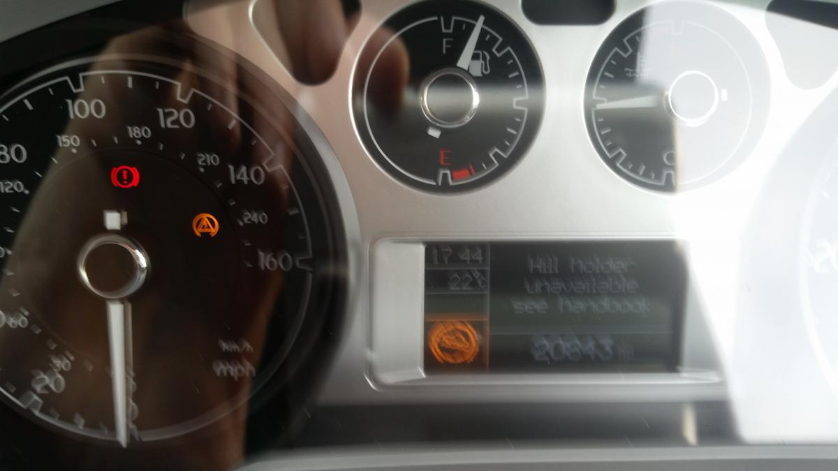

Hi,
In the past 3 days the message hill stop assistance unavailable and warning light has come on twice. It goes off when I switch the engine off wait a minute and restart it. Is this covered under the 3 yr chrysler warrenty? ? Anybody else have this problem an how did you sort it?I'm guessing it's a sensor problem.....
Thanks in advance for any help

Brake lights on/off - Hill Stop on/off. Sounds like a gremlin within the entire braking system..... Ask the dealer to go through the entire braking system with a tooth-comb - especially the sensors. Sounds like the car is not sure when you a braking/requiring the car to be hill-held etc. Must be a sensor somewhere. (though brake lights are normally push-button/sensor activated by the pedal.)
Hope you get it sorted.
Chrysler came out to me today they managed to sort the brake lights it was the sensor under the brake pedal had got stuck down causing the break lights to stay on, which was also causing the hill stop to not work as it's being told the brakes are being used another words confusing the sensor.... It is working ok now but will need to be replaced. So sticking to my original appointment. Something so stupid, thank god.
